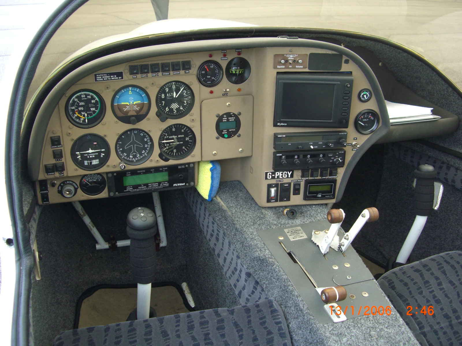

I have recently purchased a Europa and the 6 little warning lights have no labels on them.
What i have is.
TCU Switch,
Red Warning light , Marked as, Engine Warning (??????)What is this.
Red Warning light, Marked Starter
Red Warning light, Unmarked
Amber Warning light, Unmarked.
What are the Standard Warning Lights installed ?
Still have mag drop on left key position, or the bottom plugs.
Changed Plugs, leads, and Caps, Still runs rough, Have not flown it yet.

PostPosted: Sat Jul 07, 2012 5:26 pm    Post subject: The Standard Warning Light Reply with quote
Alan,
Where are you located? Are there any experienced Europa folks any where close?
A couple lights will be difficult to determine.
If you have a Rotax 914, the amber light and one of the red lights (probably the one next to the amber light) are TCU warning lights. They should come on flashing when the TCU is powered up. This indicates the TCU is in self test. Then the lights should go out when the TCU test is complete and all is well. If they come on during operation, you have a problem. Get or download a copy of the Rotax operators manual (and all the other Rotax manuals for your engine) to study up. They are available for download in PDF format from Rotax-Owner.com and other Rotax support sites.
The red lamp marked "Starter" is probably the starter engaged light. This light is usually yellow for distinction and so you don't have a bunch of unmarked red lights. It should come on when the starter is engaged. Purpose is to know if the starter contactor disengages after engine start.
The red warning light marked as "Engine Warning" may be associated with an Engine Information System (perhaps the GRT EIS 400?). If it is, it is a visual indication that some engine parameter is out of range. Then you check the EIS for details. If it is and EIS 400 the bum parameter will be flashing on the screen.
Unmarked red light not associated with starter or TCU is anyones guess. Wire trace time.
Understand, these answers are just guesses from personal experience with a couple Rotax 914 powered Europas. Could be all wrong with your particular aircraft. Every Europa has been built by and individual who had to decide how he wanted his panel to look and function. Often this was done without respect to any other aircraft. Good luck, get as much documentation as you can for your aircraft. Join Rotax-Owner.com to get access to support and useful video training. Join the Europa Club at theeuropaclub.org for more support.

PostPosted: Sun Jul 08, 2012 1:48 am    Post subject: Re: The Standard Warning Light Reply with quote
Hello Bob
I live in England in the County of Kent, And have joined the LAA and Europa Club.
First Aircraft purchased.
I will check all again shortly.
TCU, Two lights + Switch , Maybe Amber and Red, Have not seen these operate , with engine master switch on , with engine running or stopped. (only the Amber at very low RPMs) Alternator or TCU >> ????
Starter, yes this one is labled, and does go out after start up.
Low Voltage Light, yes would think one is , But no lights showing with Master On, and engine stopped, Will check this out again. ( Has a Volt meter gauge) shows about 13 volts.
Now , i have seen the Amber light come on during my engine run plug testing, it come on at rough running when the engine is at very low revs, now it this a TCU warning or a Alternator low volt warning.
Have No EFIS ete
Low Oil Pressure, How can i check this, one would think this would be on before the engine is started. But with the “Master ON� i have “No Lights Showing�.
FLYdat Engine Display, I think this is telling me it has not been reset after engine service, As after putting the Master switch on, it comes up with “service� then after say 30 sec it displays cold engine parameters.
Move key to start engine it goes off and displays� Service “ again, then comes back on line after the engine has started and works OK,
But this display of “Service� in the display is there for a least 30 to 40 seconds before you get the engine readings displayed. So no indication at initial start up.
No little Red Warning light as far as i know, So i think the Red Engine Warning light it to do with the TCU.
Alan

PostPosted: Sun Jul 08, 2012 3:13 am    Post subject: Re: The Standard Warning Light Reply with quote
Hi.
I have tried to contacted the previous owner, and left messages.
As you can see from photo.
Red =Starter
The TCU switch has each side a Red and an Amber , the Amber has come on at very low revs so i would guess both of these are TCU related.
the one marked Engine Management maybe to do with the Flydat
and in other standard cockpits one has been a spare , so 6 in total .
I will have another check on it.
Many thanks.
Alan

PostPosted: Sun Jul 08, 2012 4:59 am    Post subject: The Standard Warning Light Reply with quote
HI Alan,
Surely, there must be a kindly Europaphile somewhere in your vicinity who can assist you with your new Europa. Good fellow, welcome to the Club!
Looking at your picture of the instrument panel. (Nice panel, by the way)
Yes, TCU switch and the unlabeled red and amber lights to either side are most certainly for the TCU. Switch is an emergency shutoff for the TCU should there be an issue with the turbo control. It would normally be ON during all operations. Off only in an emergency failure of boost control.
Functioning of the lamps on start-up.
According to the Rotax Operators Manual:
"3.4) Engine start
|--<snip>
TCU Function test of TCU
|--<snip>
Lamps For approx. 1-2 seconds both lamps illuminate and then extinguish. If not, check as per Maintenance Manual is necessary."
When I go to the hanger later this morning I'll confirm how the red and amber lights should operate during TCU starting check, but I believe that is correct.
As for the function of the lamps in operation...
From the Rotax 914 Operators Manual:
"4.4) Caution lamps
4.4.1) Red boost lamp of TCU permanently illuminating
In case of exceeding the max/admissible boost pressure, this has to be recorded by the pilot in the logbook, stating the duration and exact time of exceeding of limits.
discussions of cause and remedy…
4.4.2) Red boost lamp of TCU blinking
In case of exceeding the "take-off" time limits, this has to be recorded by the pilot in the logbook, stating the duration and exact time of exceeding of limits.
4.4.3) Orange caution lamp of TCU blinking
In case of blinking of the orange caution lamp of the TCU, this has to be recorded by the pilot in the logbook, stating the duration and exact time of exceeding of limits.
cause-indicates a failure of a sensor, wiring, TCU or leakage in the airbox.
discussion of remedy…"
Go to Rotax-Owners.com and down load PDF copies of all the Rotax 914 documentation.
"Starter" red light seems to work as it is supposed to.
Red light labeled "Engine Warning" is probably associated with the FLYdat Engine Display (essentially an EIS) and probably indicates some engine parameter out of range and necessitates a look down at the FLYdat panel to see what's wrong. I don't have a FLYdat and am not familiar with them, but I have a GRT EFIS 4000 and that's how it works.
I would have no idea what that unlabeled red lamp is over the G-Meter. Hopefully, the previous owner can tell you.
For the remainder of the function of the FLYdat, you'll have to work with someone in your area who has one.
I hope this helps...

PostPosted: Sun Jul 08, 2012 11:36 am    Post subject: Re: The Standard Warning Light Reply with quote
Hi Bob.
Thank you for your detailed reply, I agree with all of your comments.
I purchased the aircraft on 8th June and it was ferried to Headcorn on the 20th, this is when i found the rough running on the left mag,
So its been a month and i have not even flown it yet.
I have managed to talk to the previous owner and he tells me the Flydat has been showing "Service" for some time, and is brought about by exceeding a parameter, say a prop over-speed, and only Rotax can Reset the unit at probably some extortionate cost .
He has been flying with the unite like this for some years,,
This is not good practice, and i am not sure if the warning lights do there pre start checks with Service showing, will check tomorrow.
Also i am not happy with the mag drop .
Having said this i understand a little, as this is Rip Off England,you pay 50 bucks for a Spark Plug Cap, and we pay £33 (47 dollars).
But it looks like i will have to have this Reset and most likely a Technician
to sort out the mags, as i have changed the plugs,leads,caps, so now special test needed, as these ECU are £880 each, apparently a Ducati motor cycle part with a different number ???
Regards.
Alan
Regards.

But Today i have made progress ,set off despondently this morning,getting at the Mags is a Pigs Ears of a job , having to remove the induction manifold to get at the Mags Coil Units,
4 of them and they spark on the compression and the exhaust strokes .
Disassembled the Mags and swopped over the Coils, reconnected, fired up, and the problem was now on the RIGHT key position, so now i have the “little blighter�
a faulty Ignition Coil that sparks the Two Front Cylinders,
Looks like the Part costs £350 including Postage Vat, So when it arrives it will take me about 2 hours then all should be well.
By the way i have checked out those little lights , red/starter, red/Flydat, and Red and amber which cycle for 2 secs to check the TCU, then one red i think this is a spare.
To Reset the Flydat it has to go back to Rotax or it need a Rotax Service computer at hand.
Alan

I have installed the new mag coil today, and it running smoothly now.
From the engine log i noticed a new coil was fitted in 2009 did not say which one was replaced,
The engine is running smoothly now, but never having a comparison or owned a rotax before i don,t know what to expect.
At 4000 RPMs each mag drops at least 300 rpm , but both now are smooth and have same drop, It is very difficult to get an accurate reading from the Flydat as its digital and not steady. But i would say the engine sounds much better now.
The 6 Little warning lights, Now 5 of them OK.
But the Red ????? Alternator? Battery ? Light, Function of,
Master switch on, Alternator on, the red light comes ON,
I would expect this as its not charging,
Start engine it goes OUT, sound good to me.
Volt meter showing now 13 volts , all OK.
Now if i turn the Alternator OFF.
The little red light remains OFF ??? No power from the Alternator so it not warning me of Alternator failure .
The volt meter drops to 12 volts as expected.
So what is this little red light, Low Volts, or Alternator or Battery
Alan

This is normal. The Rotax alternator is a permanent magnet alternator, so there is no way to turn it off. When you turn your alternator switch off, you just disconnect the alternator/regulator output from the bus. Then the alternator is still working normally, so the Alt warning light does not illuminate.
Note that it is not good practice to run the engine with the alternator/regulator disconnected from the bus, as this may damage the voltage regulator.
Remi

Many thanks, that just what my Light does,
So you can only see if the Alternator is working by the voltmeter.
But if the Alternator Fails the light comes ON.
So i will label it Alternator Failure.
All the Best.
Alan
