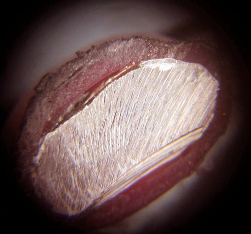

I noticed that crimp-on terminals were used on the solid leads on the diode. It was my understanding that using crimp-ons on solid wire was not recommended. Am I misinformed....again? Smile
Is that something I wrote? If it was, I cannot recall
a context where that would be true. Here's a photomicrograph
I just shot for 22AWG solid wire (diode lead) crimped into a
red PIDG using an el-cheapo crimp tool.
[img]cid:7.1.0.9.0.20120713183738.01e17628(at)aeroelectric.com.0[/img]
I couldn't find my polishing disk so the smoothed end is
rather rough. Normally you'd be able to see the ring of
tin plating on the wire at the interface between wire
and terminal barrel. Nonetheless, this photo confirms that
the two metals to be joined have been upset with sufficient
force to make them essentially one with no voids.
Emacs!
