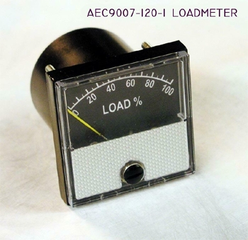

This is often handled by not calibrating the ammeter
in AMPs but in PERCENT of full load for the devices
being monitored. For example, the ammeter we offer
[img]cid:.0[/img]
Is calibrated in percent. We then offer a variety of
shunts calibrated to the instrument and scaled to the
load being monitored. For example, an SD-8/60A combo
would call for a 10A/60A shunts. An SD-20/40A combo
would be 20/40, etc.
When you have a digital display like Dynon, it may
come to you with a FIXED input sensitivity for full
scale, like a steam-gauge . . .
It may be programmable either from a local keyboard
or USB input. But in any case, it's probably NOT capable
of different sensitivities. In the situation we're
considering, 40A, 50mv shunts give accurate readings
on the Dynon . . . irrespective of the size of the
device being monitored.
