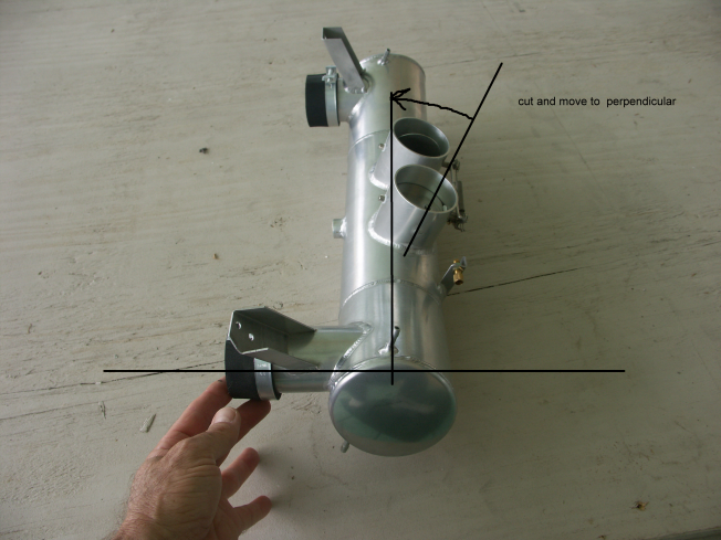

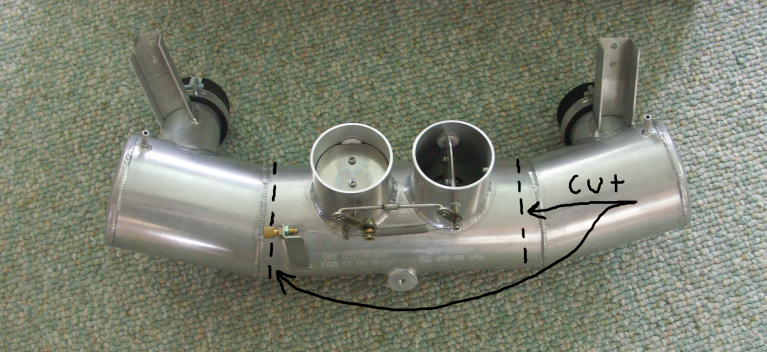

I have the old Skyshop 701 Rotax FWF which uses the bed mount and the Rotax airbox. But their plans show that you have to modify the airbox to make it fit. The photos they provide show the center section being sliced out and rotated about 15-20 degrees such that the two intake tubes are at 90 degrees relative to the carb outlets. Pictures (Matronics willing) attached.
