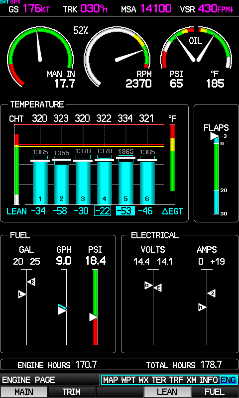

As bob states, your assumption is correct Rick. The problem is that zero degrees becomes the first stop and then you only get to choose one more prior to full flaps. I think Marc was talking about adding an additional intermediate stop. On the Garmin G3, the display is not so elaborate as the dynon. It is just a bar graph with a sliding pointer.
Bill
WA0SYV

Strasnuts
Joined: 10 Feb 2009
Posts: 502
Location: Salt Lake City, UT
PostPosted: Fri Jul 13, 2012 8:59 am    Post subject: flap positioning Reply with quote
My G3X shows each position.

PostPosted: Fri Jul 13, 2012 2:34 pm    Post subject: Re: flap positioning Reply with quote
I didn't mean to imply it did not show the position, it just is not curved and
as fancy as the dynon graphic
Bill
