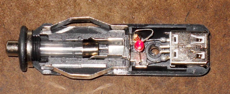

Just smoked a rechargeable MP3 player by attempting to
power it up with what appeared to be a cigar lighter to
USB power port power adapter.
After the smoke cleared, I opened the critter up to find
that somebody thought it was a good idea to use this
ubiquitous connector for some kind of 12V application
too.
[img]cid:7.1.0.9.0.20120629144146.01e0ccc8(at)aeroelectric.com.0[/img]
Just a heads-up . . . when in doubt check it out. Some electro-
whizzies one might wish to power up from such a device could be a
whole lot more expensive than my $29 mp3 player!
