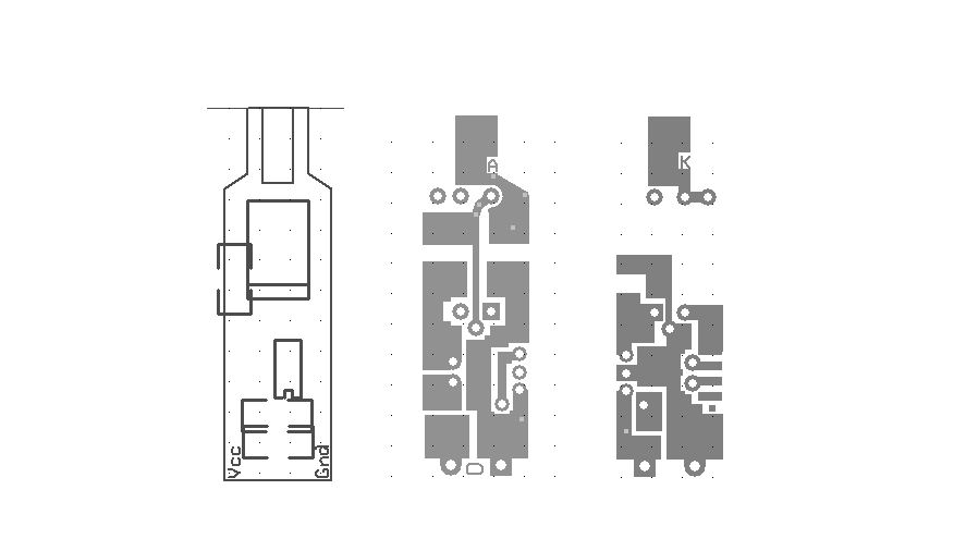

I can't solve the ExpressPCB issue in general, but what I do is use a "screen-capture" like the screen grabber import function in Paint Shot Pro. (I use this to grab all layers of a pcb, then flip one layer, to produce folded mockup paper boards for circuit tracing and examination before sending board out for manufacture.)
This is a good function to have at your disposal for capturing all sorts of images. If you can see an image on the video display, then you can grab it and manipulate it as a BMP. JPG, etc. Then you can print anything as a pdf using Smart PDF Converter or other free or cheap pdf converters.
There are free older versions of Paint Shop Pro for the taking online.
