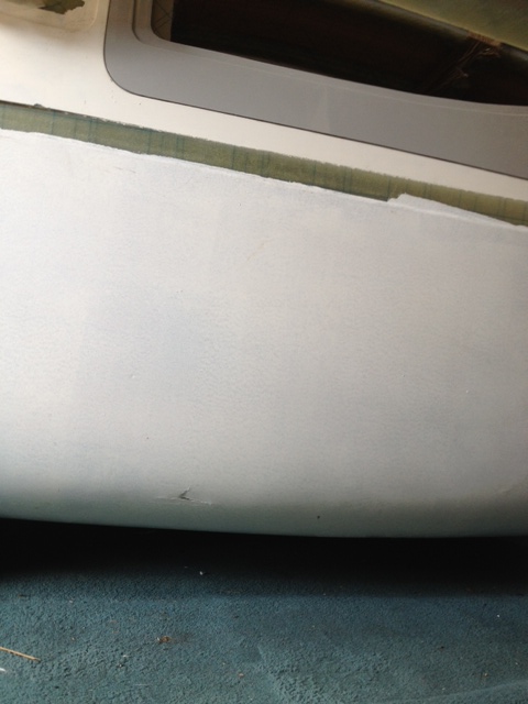

I'm new to the forum have just purchased a part built Europa kit. However whilst transporting it back home it sustained some damage to the fuselage ( see picture attached) the reason for my post is to ask your opinions as to how best to repair this damage?
The kit is in storage at the moment but will be getting moved to my workshop within the next couple of weeks to allow me to start my build process. My thoughts are before tackling anything else I need to make a proper repair to the damage sustained to the fuselage before continuing with the build.
When my inspector comes to check my workshop I will obviously discuss the repair with him and get his opinions as how best to proceed with repairing the damage.
I would value any opinions and options from yourselves as to the best options to make a repair to the damage.
Many thanks taking the time in reading my post and I shall look forward to receiving your thoughts and solutions.
Kind regards
Fireflier

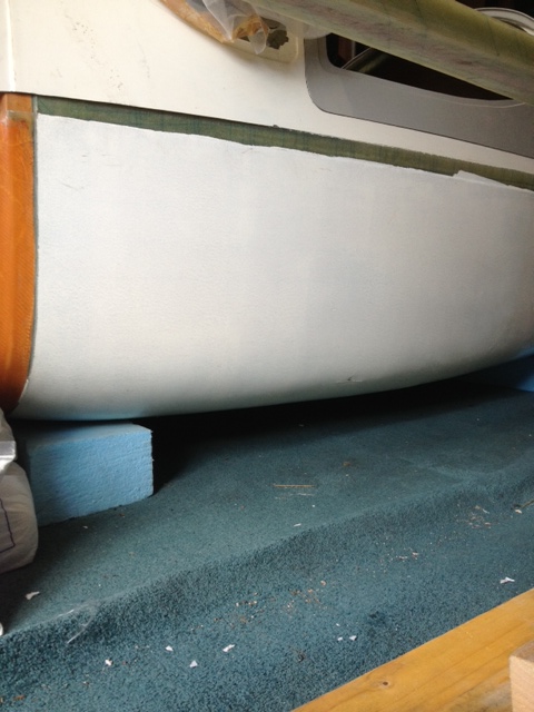

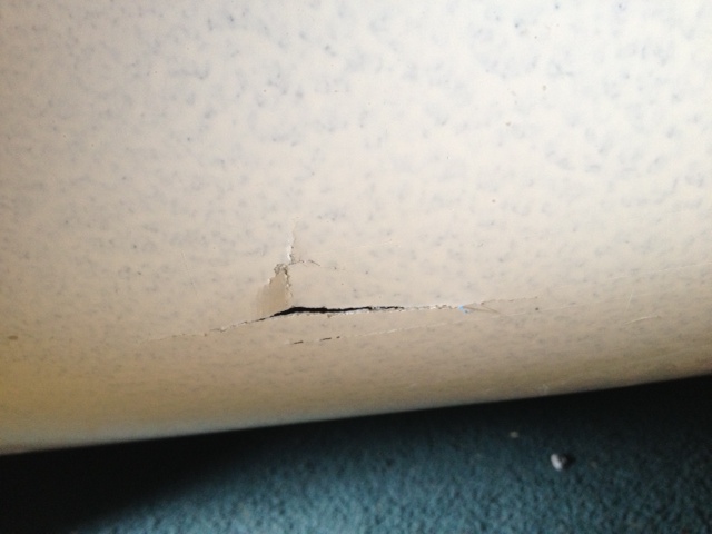

PostPosted: Mon Jun 25, 2012 4:39 am    Post subject: Re: fuselage repair Reply with quote
Hello
Many thanks to everyone for their replies to my earlier question its much appreciated.
I have posted more photos showing roughly where the damage has occurred to the fuselage.
the space to take the photos was limited so they are still not great but didn't have anyone to help move the fuselage out to get better pictures sorry.
Looking inside the fuselage it appears to be on a part of the fuselage that does not have any foam as part of the fuselage construction, therefore I presume it is not part of the fuselage subjected to stress?
I have now joined the Europa club.
Many thanks for all your comments and suggestion's they are much appreciated.
Kind regards
fireflier

PostPosted: Mon Jun 25, 2012 11:56 am    Post subject: fuselage repair Reply with quote
The reason there is no foam at that location, is because that is where the
cockpit module will get bonded in
On the inside, which will add a lot more strength once it is installed
