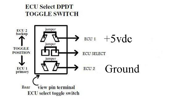

I think that the Viking powered aircraft can be wired, for the most part, using one of your drawings. There is one item unique to the Viking that is not addressed: ECU SELECT. The Viking website recommends using one DPDT switch wired in parallel to act as a SPDT switch. This switch will select either a high or low voltage and send it to the dual ECUs to enable either ECU1 or ECU2. My concern is that if this switch fails, the pilot will not be able to switch to the backup ECU if needed. Or if the switch fails open, who knows which ECU will be enabled, if any. It is unknown what bad things might happen if both ECUs are enabled at the same time, even for a second.
Is it safe to use one switch to choose between ECUs? If not, is there a better way than to use 2 mechanically interlocked switches? Perhaps a solid state circuit powered by the aircraft supply so that it would not load down the ECU.
Joe
No airplane is safe . . . every airplane ever built will
terminate your existence in a heartbeat. Some more
easily than others. The BD-5 comes to mind. Each comes
with varying levels of risk that are dependent as much
upon pilot knowledge and skill as system reliability.
FIND OUT if the operating the two ECUs in tandem
presents a risk. FIND OUT also how much current these
systems demand in cruising flight. If dual ECU ops presents
risk and assuming that the builder is driven by the
ultimate in simplicity, then use two separate switches
with the #2 being annunciated with a really annoying
light and taking power from a separate battery. Might
even space the #2 switch off in it's own corner of the
panel.
The point being that if all this modern equipment
operates true to history in its automotive applications,
then it's unlikely that #2 ECU will ever be needed
in flight. The only time #2 is ever turned on is in
pre-flight, on the ground and in accordance with
check-list procedure. As you've already perceived,
this "keep me from throwing the wrong switch" interlock
philosophy may add more risk than simply having each
system stand alone.

This builder needs to FIND OUT how much current each
of the ECU power inputs need.
Unfortunately there is only ONE power input to the Dual ECU. I find it hard to believe that the ECU manufacturer would provide only one power input to their dual ECUs. I suspect that the Viking Engine developer, Jan Eggenfellner , has elected NOT to use a second available power input. I do not know this to be a fact. It is just speculation on my part.
Then find this out. Anyone willing to launch into the blue
without answers to such questions is an accident waiting
to happen . . . either from ignorance of this specific
question or others like it.
Unfortunately, Mr Eggenfellner has not answered such questions, probably because he does not know the answers. He is a good mechanic but might lack electrical knowledge.
This question has been asked on the Viking website with no response from Mr Eggenfellner. If my assumption is correct that a high signal enables ECU1 and a low signal enables ECU2, then it would be impossible to operate both at once. No one knows the consequences of the simultaneous application of both high and low signals to the SELECT wire or the consequences of an open floating input.
My friend is making the final decisions on wiring his airplane. He has accepted some of my recommendations and rejected some.
From my point of view, it is hard to design a fool proof system without knowing the requirements or answers to above questions. All I can do is ensure that power is always available to the lone ECU power wire, regardless of the failure of any one component. And ensure that there is either a high or low signal on the SELECT wire, but never both at once.
I think that we agree that the electrical system for the Viking engine has not been designed with a backup plan in the event of failure of key components.
I am happy with my Rotax 912 engine.
Joe
