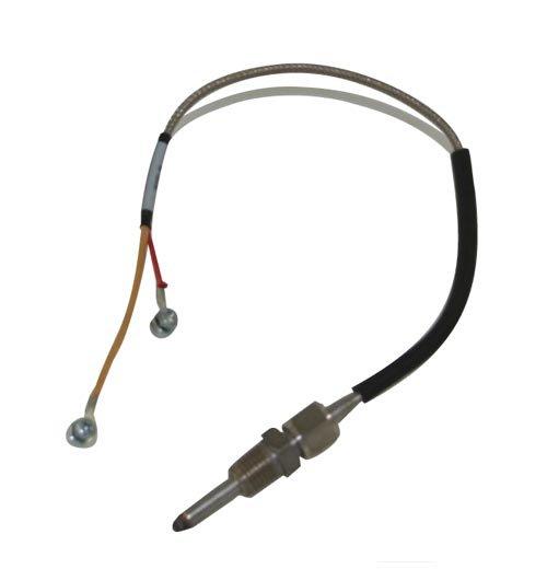

I have a thermocouple of the type shown from AC Spruce. I was getting erratic high temp readings and my hangar mate found that the ring terminals on the thermocouple were cutting into the insulation of the adjacent wire and causing a short.
I need to reconnect the wires and would like some suggestions as to a good method. I don't want to go back with ring terminals for obvious reasons, If I use inline crimp connectors, will this affect the reading since these connections would only be about a foot from the exhaust manifold and still inside the engine compartment.\?
Any better suggestions available??
Bill B

PIDG butt-splices are fine . . . but permanent.
Is there enough slack in the wires to allow clipping
out a butt-splice and replacing it perhaps a half dozen
times?
You can also silver-solder a j-hook joint and then
put heat shrink over it.

The red wire insulation seems to be cracking. Will I burn it with the torch when I try to silver solder it?
Bill B

You need to use a very small butane torch
http://tinyurl.com/7mm63u4
my personal favorite is a Bernzomatic product
http://tinyurl.com/7mucxz5
which you can often find at Lowe's, Home Depot,
et. als.
But you will still damage a small amount of insulation
which you'll cover with the shrink.
