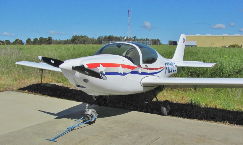

Here is picture on the ground.

Very pretty paint job. Congratulations on your first flight!
