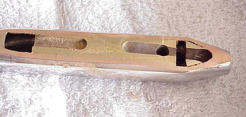

A modern pitot tube is a complex study in aerodynamics, pneumatics, thermal dynamics and manufacturing. Contemporary design goals for a 'qualified' pitot tube calls for testing in an icing tunnel that is supposed to be sort of a worst case icing condition.
http://tinyurl.com/7pmnqta
[img]cid:.0[/img]
The idea is to melt any ice accumulation and provide a place for the moisture to go besides into the pitot-static plumbing. At the same time, many airplanes are fitted with accumulators at the system's low-spot that include a drain for removing any water.
Some years ago at HBC, we had a series of incidents involving loss of pitot data on both sides at the same time at altitude with no visible moisture (clouds or ice crystals). Both systems recovered before the airplane landed and draining the accumulators produced no observable moisture.
The pitot tubes installed were grand-fathered over from earlier installations and not 'qualified' to the latest and greatest de-icing specs. In fact, the tubes were originally installed pointed up at about 45 degree angle and had been moved to the bottom pointed downward thus placing the drain hole in the wrong clocking.
New, latest and greatest tubes were installed. I'm not aware of any recurring incidents . . . need to make some phone calls. I'm a bit skeptical. I did some flight tests on the original tubes to measure internal and temperatures. The areas all over the tube remained well above freezing (LT1, LT3, LT4 curves
in http://tinyurl.com/74yr5q8 )
The idea that there was frozen blockage of passages inside the tube didn't compute. So even if water did run down into the plumbing, where did it come from? Thawed ice crystals? Your guess is as good as mine. In any case, position of the drain hole was certainly not a high order concern. What I did come to understand was that unless your heated pitot tube is mounted to a machine qualified for flight into known icing, the ability to heat the tube is of limited usefulness. Once the tube is overwhelmed the flight characteristics (airfoil shapes) combined with added weight of ice make sort of pollutes the value of knowing indicated airspeed. The recommended process being to get to warmer altitudes without without changing anything that would move you closer to the low-speed corner of a flight envelope that is no longer defined.
What you have is probably a fine device for use outside of icing conditions. Inside icing conditions becomes a toss-up as to whether the flight qualities airplane or the instrumentation get overwhelmed first.
Wire that heater up if it makes you feel any better but know that having good IAS numbers is only part of the equation. Got a real good lesson during my only in-flight instrument approach in icing conditions. In this case, my instructor was sitting there calmly waiting for me to figure it out all the way down to the flare after having kept all the needles centered up for over 15 minutes in the clouds.
The airplane fell out of the air and muffed what was supposed to be a good "by the numbers" landing . . . numbers that no longer represented the shape of the wing. Bottom line is that ice presents worries that can be a lot more hazardous than IAS numbers.
