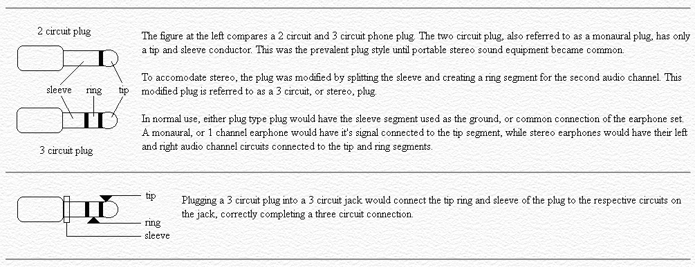

PostPosted: Tue May 29, 2012 9:19 am    Post subject: Found it! Reply with quote
I also had a radio noise problem that I finally traced to the audio out line on my 396. It is installed in my panel in an Air Gizmo mount. Turns out the audio out wire was kinking against the back of the mount when I'd stick the unit in.
I cut away some of the plastic mount right behind the audio out plug, which alleviated the kinking and stopped the radio interference...
Tom

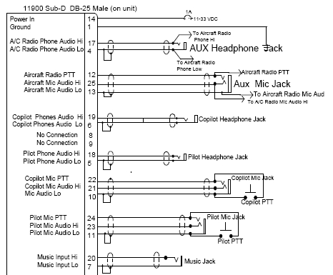

PostPosted: Wed May 30, 2012 7:26 pm    Post subject: Found it! Reply with quote
I did get to the hanger today and quickly pulled the wires out into the open that has the 3.5mm plug
(one that goes into the Garmin). Can you explain the lo / hi audio wire thing.
In a monophonic audio cable with 3.5 mm plug, the tip is
connected to the signal/center/hi lead, the sleeve is
connected to the shield/ground/lo lead.
A stereo cable adds another free conductor and the
two signal wires become right and left audio. The
shield/ground/lo lead still connects to the sleeve.
The larger analogy can be seen on a legacy microphone
connector
http://aeroelectric.com/articles/micjack/micjack.html
Am I to understand that
the lo is to be soldered to the ground? This may be my goof as I purchased this plug (which
is stereo and my intercom is not). I think I may have soldered the two wires to right and left and the ground
might be left out in the cold. Will need to double check, but I looked up the PM 1000 pin-out after I
got home so it may be in the soldering of that plug. I purchased the solderable mini plug in stereo
config as I wanted to hear the music / alerts in both sides of headset.
I'm confused. If you have stereo headsets, then you would
need to install 3-circuit jacks and tie both r/l audio
from headset together to be treated as a mono headset.
This is the only place you would use a 3-ckt jack.
The PM1000 MUSIC IN is monophonic which would required
blending r/l channels together BEFORE wiring the blend
into pin 20 and the lo/gnd side to pin 7.
[img]cid:.0[/img]
This would call for a 2-ckt plug to do the mate up between
the Garmin and the PS1000. And just for grins, I'd use
pin 7 of the PS1000 for BOTH audio ground and DC power
ground for the Garmin.
http://tinyurl.com/7ypuofg
[img]cid:.1[/img]
[quote] Unless you have stereo audio to handle, a simple 2-ckt plug/jack combination will suffice. The mis-application of the 3-ckt jack may indeed be contributing to your problem.
Bob . . .[/b]
