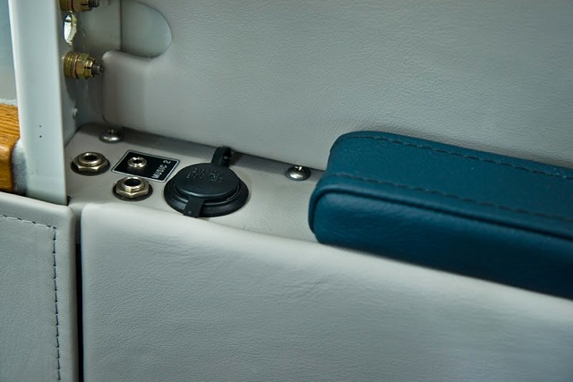

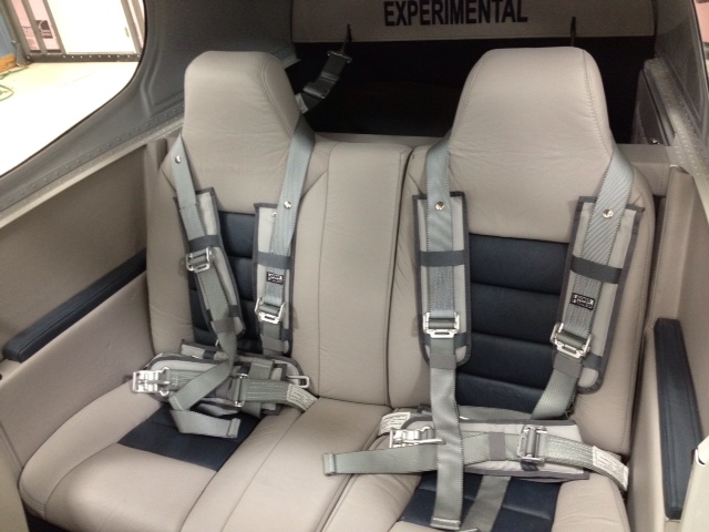

Todd,
That us exactly what I did. I had Abby leave a 2-3" opening in front of the arm rest. I had her send me some extra leather and glued the leather to the aluminum side panel where the jacks go, then installed her panel. I have good pictures at home. Here is a picture where you can almost see it.
I'll try and remember to send you the detail tonight. It turned out really nice!!

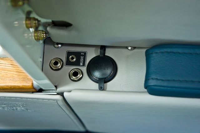

PostPosted: Sun Jun 17, 2012 5:39 am    Post subject: Mounting rear seat headset jacks Reply with quote
Todd,
Here are the pictures of my install with Abby's interior.... The area under the jack just has one layer of leather, no foam. Then the side panel is attached .
I hope this helps!
-Mike Kraus
