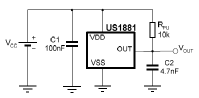

On the other hand, a 'hall effect device' for RPM
sensing generally depends on an external magnetic
field (like the one that spins around the shaft of
a magneto). It's usually a 3-wire device (ground,
signal and power) but CAN be a 2-wire device for
accommodating instruments. These need to be powered
up by 3-15 volts DC and the output signal is generally
a square wave, again frequency equal to pole passages
per second but an amplitude fixed to some value close
to the power supply voltage.
[img]cid:.0[/img]
So if the sensor you're trying to test is indeed a Hall
Effect device, you'll need to wire it up to emulate the
power supply and signal loads present in normal operations.
Observation of a the output signal will require an
oscilloscope as opposed to a simple voltmeter.

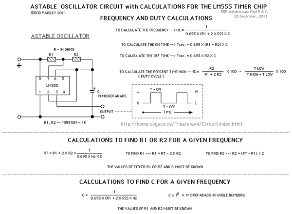

Is there a reasonably priced pulse generator that will send out a signal like this or is there place to get it locally like radio shack ?
Sure, it's called a 555 timer.

0.3me ? width. 2 pulses per revolution so about so for 2k rpm need 4K pulses per min.Is there a reasonably priced pulse generator that will send out a signal like this or is there place to get it locally like radio shack ?
Sure, it's called a 555 timer. See schematic
[img]cid:.1[/img]
According to the calculator just below this image at
http://home.cogeco.ca/~rpaisley4/LM555Astable.GIF
100 ohms at R1, 3300 ohms at R2, 4.7 uF at
C1 will give you about 45 Hz, 2700 pulses
per minute or 1350 rpm equivalent test signal.
Running this test generator on a 9v battery
would probably be close enough to the 10v pulse
generated by the Lightspeed system.

PostPosted: Fri Jun 15, 2012 5:54 pm    Post subject: G3X Garmin EFIS Reply with quote
thanks for your timely and accurate advice. I researched the internet last night and it seems a number of schools use the 555 timer circuits. Your calculations and drawing will make my my breadboard assembly easy. Unfortunately I found major wiring snafu in G3X system. The signal input wire does trace to the appropriate pin 17 of the 80 pin J732 LSU connector. Unfortunately I get a voltmeter reading of 13.5 out of this wire. The power should come form pin 58 wire but has no power coming out. It seems this system is to complex to assemble, even for a large avionics shop in northern US.
