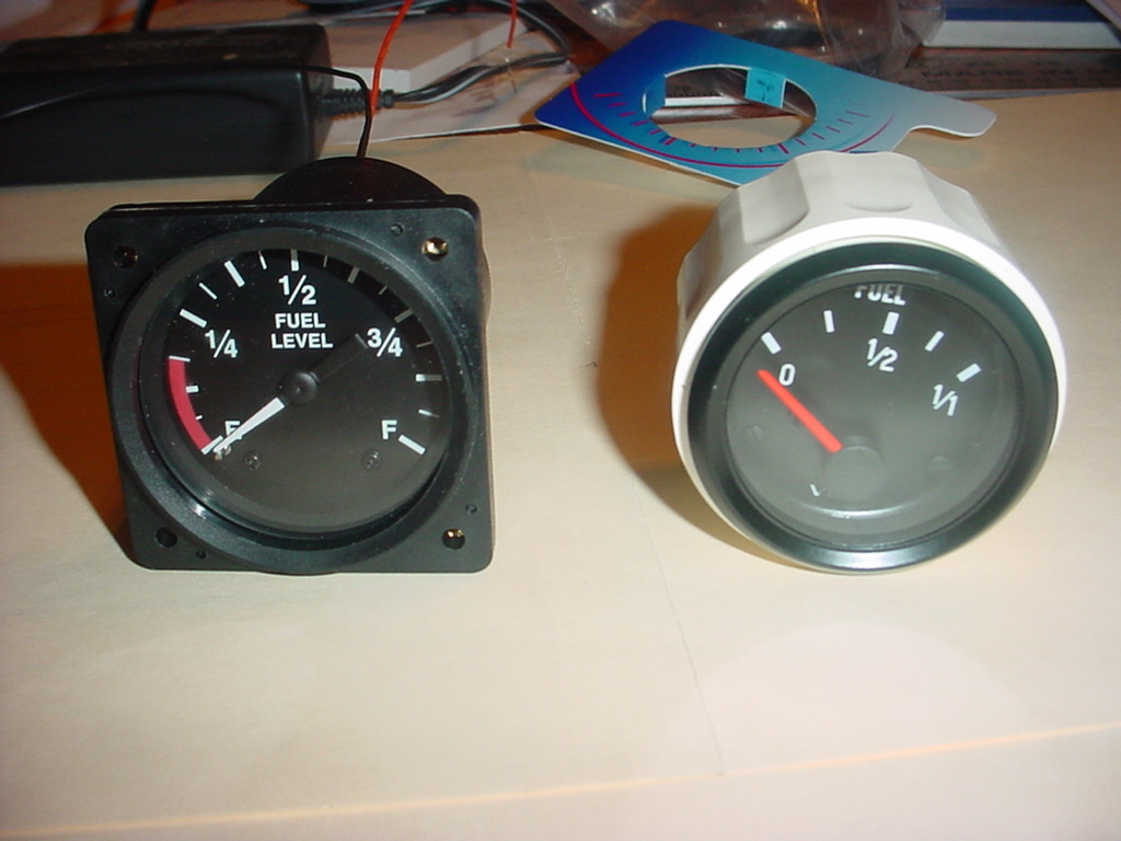

Here are some ISS and VDO gauges

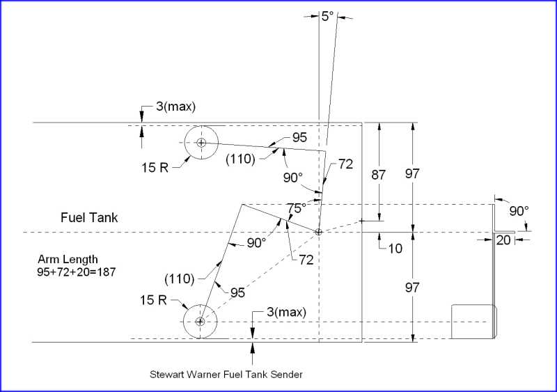

This is the drawing of my ISS Sender install in my tank.  My tanks have been modified and follows the wing profile... curved top!

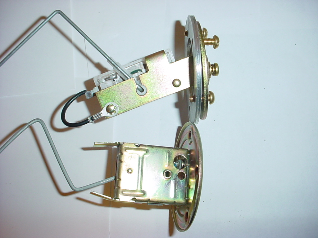

Here is a view of the ISS(top) and VDO(Bottom) Senders. Note the 1/8" flanges of the ISS unit! The ISS float arm detaches from the sender... the VDO does not!
