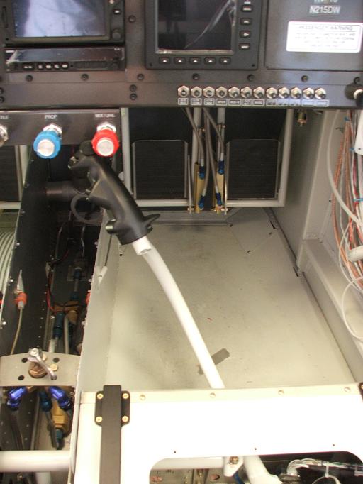

I have been meaning to send this for a while but have been too busy in phase 1 testing. This is an old problem but slightly different spin. I have the infinity stick grips and they are known to have a problem with clearing the bottom of the panel. The fix is to cut the control sticks as short as possible. This gives a nominal clearance of about a half an inch between the top of the stick grip and the bottom of the panel - the bottom strip that usually holds circuit breakers. I was careful and mine cleared the panel.
One of the last things to install are the control cables. Yes, they are too short. More interesting was the interference between the right stick and the mixture control. The right stick when moved full left could be hung up on the LEFT side of the mixture control. See the photo. This was unacceptable even though in flight it would be tough to get it there. My control cables are stock and in the design location.

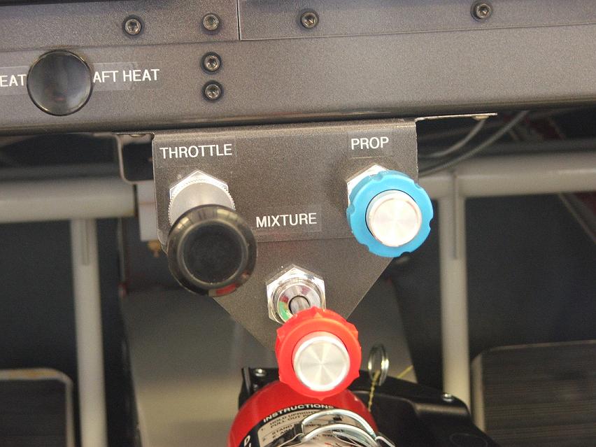

There are several ways to fix this but the one shown in the photo utilizes the stock cable. A slight modification to the support removed the interference. I actually like the fact that the mixture control is now below the throttle and prop. This minimizes inadvertently grabbing the mixture control instead of the prop.

Well, you're right, that would not be acceptable. Are you sure the right stick is vertical with the ailerons neutral? On mine the stick just barely touched the RIGHT side of the mixture knob, full over to the left. I adjusted the stick position (under the right seat) a bit, and now it doesn't touch.
BTW, I found I could hang up the stick if I moved to a certain position in a certain way. The culprit was a bolt under the seat in the control mechanism. I installed it per plans and it could hang up. The fix was to reverse the direction of bolt. The head wasn't long enough to interfere with the head forward.

On my plane I cut the sticks down to just barely enough to mount the
Infinity Grip. I also replaced the control cable bracket with a more narrow
one (but keep the same knob spacing). This provides just enough clearance.
Both cabin heat, alternate air and oil cooler air controls are on the bottom
panel apron.

Nice fix.
For others encountering stick/panel interference, another approach is bending the stick in a press, i.e. increasing the curvature. Lots in the archives.

There is a lot of back-and-forth adjustments to the sticks to get them vertical at the same time the ailerons are in line with the flaps and wing tips. I'm sure that was not the problem. I considered bending the stick as others have done but my wiring was internal to the stick and I didn't want to disassemble the stick grip and re-pull the wires.
By the way, when you align your sticks vertically with the ailerons locked in trail be sure to do this with the elevator in the neutral position. You do get some minor aileron deflection as you move the stick fore and aft.

I agree with you. My left leg would not let the stick go that far. I would have to lift up my left leg and move the stick under it and to the left to get the right stick to interfere with the mixture control. Nevertheless, the perfectionist in me couldn't let it be. I was also concerned that the DAR would find it unacceptable. Full control stick deflections in all corners is a standard check and you look for interference, such as mine, binding of bell cranks, adequacy of control stops, and movement of rod end bearings (not hard against the retaining bracket).
In reality though I could not see how I could actually get the stick way over there in flight.
