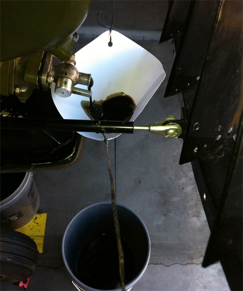

PostPosted: Thu Jun 07, 2012 4:43 pm    Post subject: drain the main oil sump Reply with quote
Oliver,
I drain the M-14P oil sump into a paper painter's funnel that has a very fine mesh screen at the bottom. It's temporarily held in place with some cable lacing and drains into a plastic bucket directly underneath. I never expect to find any metal chips, bit it's always nice to know that they are not there.
Warren Hill
[img]cid:E61B75C1-59EC-4F94-BC2C-221F121AEBF8(at)ph.cox.net[/img]

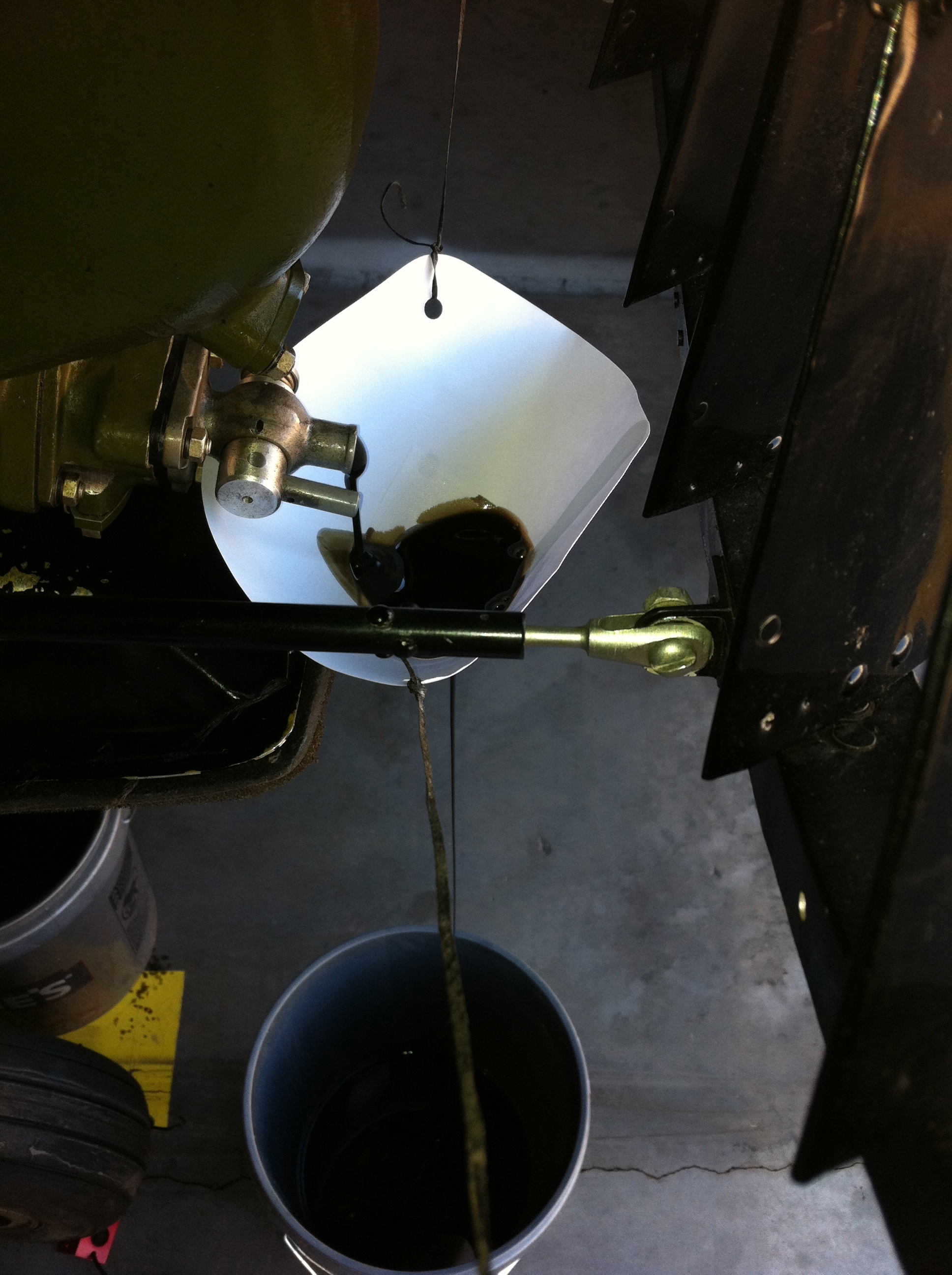

PostPosted: Fri Jun 08, 2012 5:48 am    Post subject: drain the main oil sump Reply with quote
Oliver,
I drain the M-14P oil sump into a paper painter's funnel with a fine mesh screen at the bottom. It's temporarily held in place with some cable lacing and drains into a plastic bucket directly underneath. I never expect to find any metal chips, bit it's always nice to know that they are not there.
Warren Hill
[img]cid:4D9AA5BF-03F4-447D-B335-68E5532C0907(at)ph.cox.net[/img]

ssssskippy
Joined: 02 May 2010
Posts: 58
PostPosted: Fri Jun 08, 2012 6:51 am    Post subject: drain the main oil sump Reply with quote
Thanks for your answers!
Olivier

PostPosted: Fri Jun 08, 2012 8:14 am    Post subject: drain the main oil sump Reply with quote
Looks sorta like a mouse trap..
