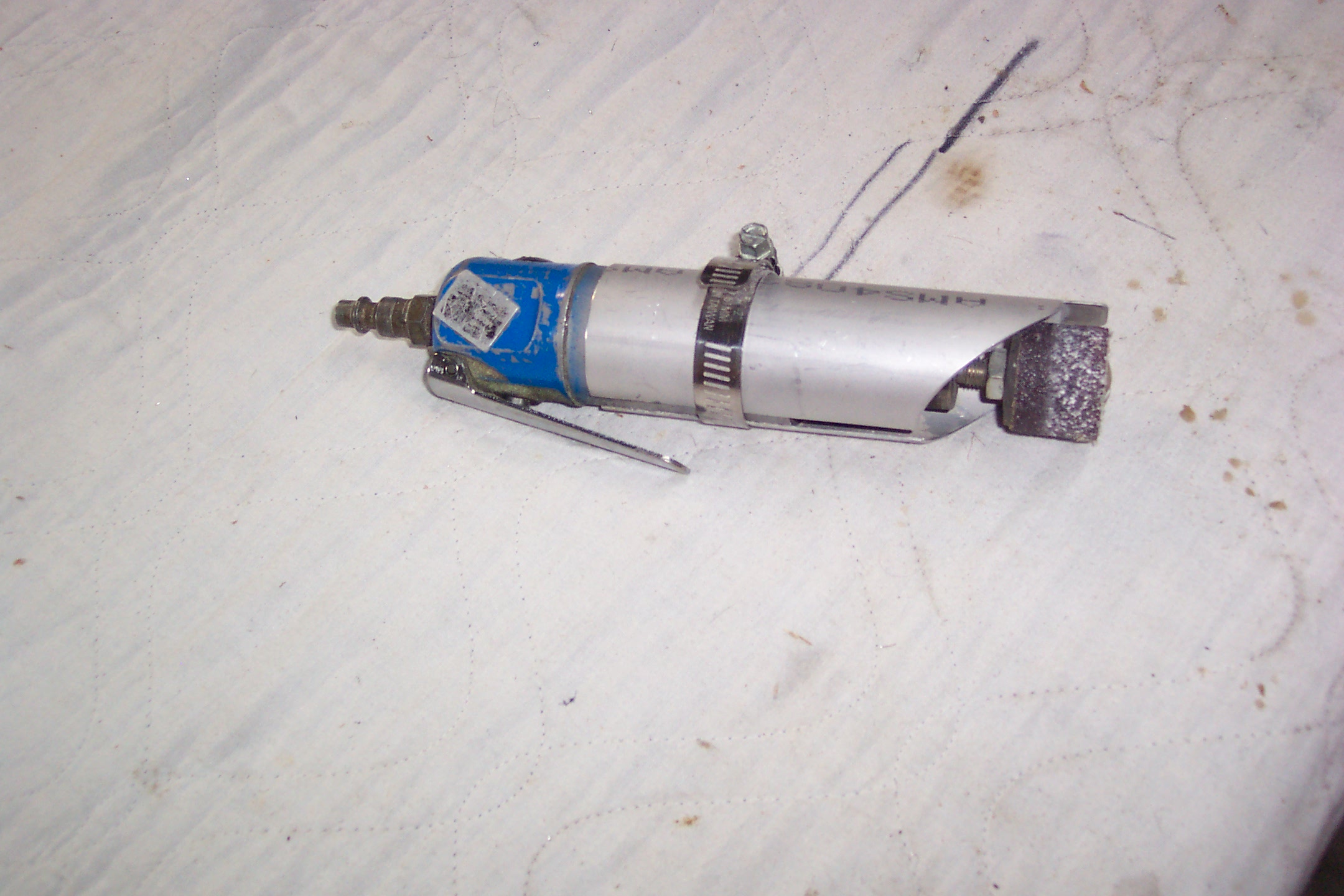

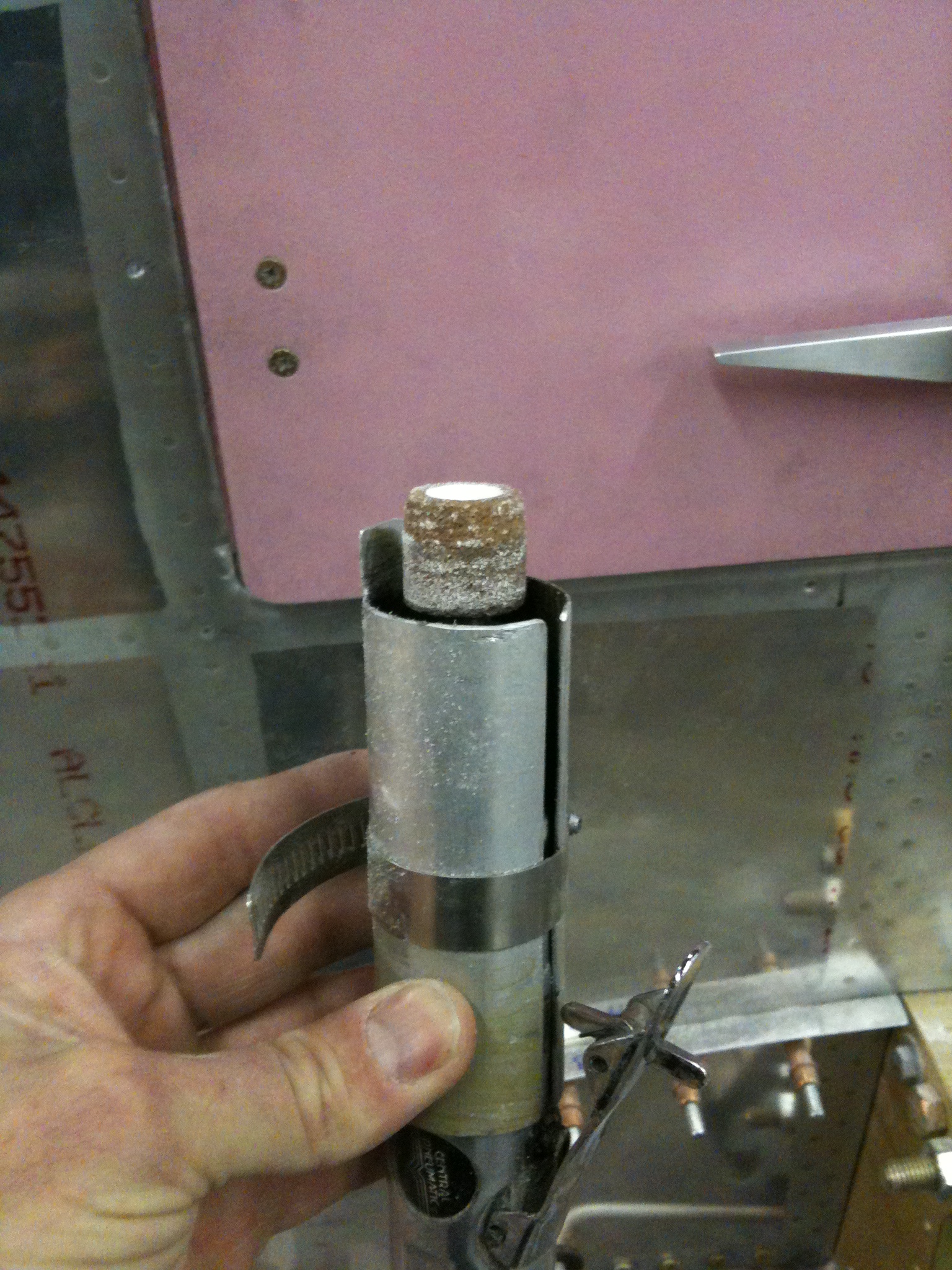

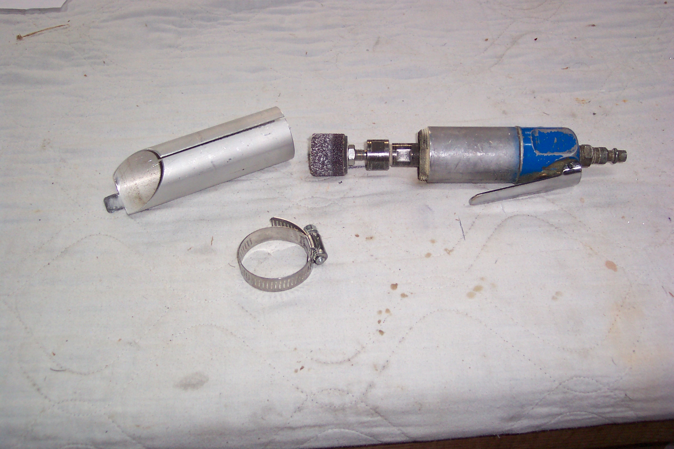

PostPosted: Tue Jun 05, 2012 3:09 pm    Post subject: Door Gutter and McMaster Seals Reply with quote
I cannot hope for a better seal and door fit on my -10 partially due to the McMaster Carr door seal. Extremely happy we used it. Like many items on the build you just have to put one foot in front of the other and one day you are flying. As far as effort we built a simple guide that we attached to pneumatic grinder and had each door precisely trimmed in 15 minutes.
Robin

PostPosted: Tue Jun 05, 2012 5:03 pm    Post subject: Door Gutter and McMaster Seals Reply with quote
Ditto for me, thanks to Robin. I copied the grinder tool and it made the job a lot easier. If I had to do it all over again, I wouldn't change a thing with the door seal. Definitely quieter than the vans seal possibly due to the hinge covers and consistent pressure around the door.

15 minutes? I'd like to see a pic of this guide. It could cut a couple
hours off my total build time on my next RV-10! Smile
Robin

Photos attached. Don't think I haven't thought about building another -10 because I already have this guide.
Robin

PostPosted: Wed Jun 06, 2012 5:40 am    Post subject: Door Gutter and McMaster Seals Reply with quote
Another pic of a copy I made.

So you guys did initial trimming with a cutoff wheel and then the grinder metal guide runs along the outside door edge with the tool doing the final trimming the remaining gutter?
Bob

PostPosted: Wed Jun 06, 2012 7:12 am    Post subject: Door Gutter and McMaster Seals Reply with quote
That's basically what I did. I used a belt sander on a lot of the cabin. I
also used a diamond cut off wheel and the grinder tool shown. This made a
consistent 1/4 or 3/16 lip for the seal to attach to. You can buy the lip
size in 3/16 or 1/4.
Personally I have a 1/4 reveal around the whole door and I feel like this is
the optimal gap for the 3/8 bulb.
Sean
