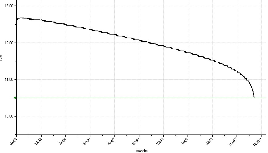

Just confirming what Ron has already asserted . . . here's
a 1-amp discharge curve on one of the batteries he sent
me:
[img]cid:7.1.0.9.0.20120609083206.01e0c0c0(at)aeroelectric.com.0[/img]
This test article delivered just over 11 a.h. at the 1-amp
so I suspect the 20 hour rate is about 0.8 amps for a total
of 12 a.h.
Both of the batteries I received were in the 180-200 amp
range for 15 second cranking currents.
