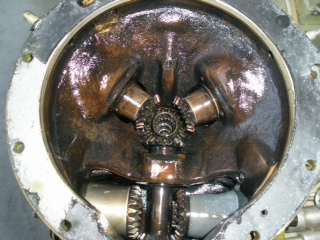

Generator splined gear drive
viperdoc(at)mindspring.co
PostPosted: Tue Jun 05, 2012 6:03 pm    Post subject: Generator splined gear drive Reply with quote
Looking at the picture: 1200 is a oil channel. Deep to that is the drive shaft for the generator. To see the drive for the generator You need to flip the accessory case over and pull the inspection plate. At 1000 & 0200 are the gears for the mags. At 0700 is the drive for the compressor. At 0600 is the drive shaft for the oil pump & the fuel pump. At 0500 is the drive for the air start octopus. If memory serves correct.
Doc
