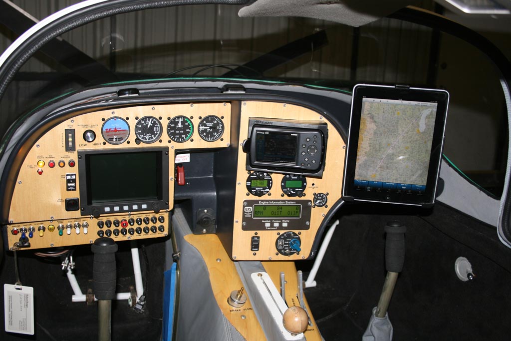

Hi Raimo,
I took a look at your photograph and it looks very nice. I do have one question though, where do you sit? Smile
Cheers, Paul
On Tuesday, May 15, 2012, Raimo Toivio wrote:
Hi Richard,
how about this?
The camera was aproximately there where is my my head when flying.
The Master ASI is well visible but a skid/ball and panel´s lower port corner not (there are some fuses, switches and a key),
In the other hand IPad´s mount is easily adjustable so I can turn it 90 degrees if I wanna see whole panel (but then IPad is not visible).
Notice: this configuration with also a new TruTrak´s Gemini ADI with TCW`s IBBS and Garmin´s 35HVS and FDS´s FC-10 fuel comp with GPS and only ONE fuel transducer has not been in the air yet but tomorrow it will. Wish me luck.
Cheers, Raimo Toivio

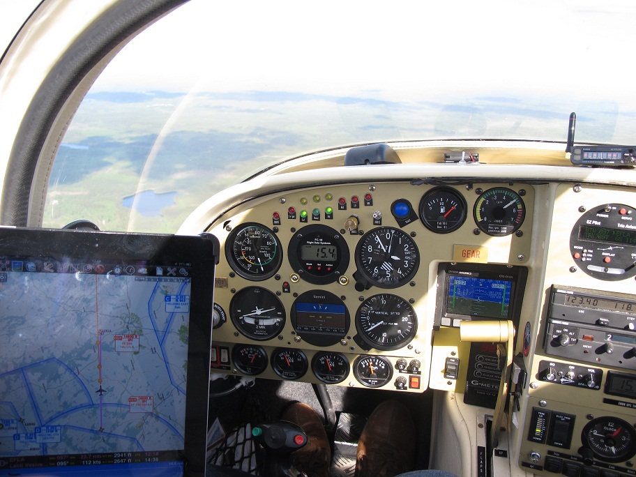

PostPosted: Wed May 30, 2012 1:27 pm    Post subject: Re: ipad mount Reply with quote
Hi Raimo,
TOOO MUUCH INFO!
I think I would have a problem with one horizon showing level, one nose down but level and a turn indicator showing a turn left!!
Ouch!
Barry

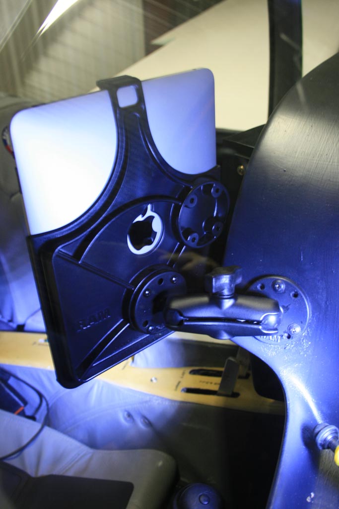

Here's how I did my iPad mount. It is a RAM mount system I purchased last year at AirVenture. It can be adjusted a fair bit to bring it closer to the pilot or to allow the passenger to operate it.
From the front:
From the back, showing the mount:
I think the clamping bar should be turned so the tightening fixture is down. That way it can be operated more easily from the front of the unit.
I may get another ball mount and try it on the mount location on the right and middle of the mount as it may provide more freedom of movement.
Hope this helps.

Barry,
you are right - everything in my plane is up-side
down. Obviously that is why I get headache when
flying. Thanks for info!
Seriously:
- (My) Dynon is quite slow to react and this new
Gemini ADI is VERY sensitive (would like to adjust
it to be slower)
- in this situation plane was descending a bit
like plane´s VSI is showing
- my turn indicator is shit (brand name is Falcon)
and it is rocking like an idiot, I have ordered a
new one
This is a statement of my American friend for your
happiness:
Cheer, Raimo
Hello Barry! Kim Prout here....Raimo and I are
having fun here in Finland and are hoping to see
more Europas at the fly-in.
Anyway, I would agree that the differences in the
instrument readings are disconcerting and
confusing. It was no problem, however to fly
in VFR conditions knowing that the Gemini was
accurate. I would recommend to builders that the
mounting holes for turn coordinator, attitude
indicator,
and heading indicator be slotted to allow for
adjustment of level relative to airplane as the
panel cannot be relied on to be level based on its
fit to the fusalage
and firewall. In N111EU I really do not power up
the turn coordinator or attitude indicator (no
heading indicator installed) unless flying in
marginal conditions. The slip/skid ball works no
matter
what so no issue there. I always thought it
unecessary to power up the gyros with master
switch just wearing them out without really
needing them for the typical
VFR flights. They just seem to be a distraction
when I should have my head up anyway.
I prefer a separate switch for gyro power...only
need to remember to turn them on when anticipating
night, marginal or IFR conditions.
OH-XRT is nicely equipped with two important
features: fuel flow totalizer with GPS interface
and wing leveler/GPS tracking. I do not have a
wing leveler in my Europa
but I rely on my totalizer for cross country trips
(and I still have a rugged sight gauge at footwell
for verification).
Raimo's ipad mount is nice with the suction cup
mount and brings the display close to his body...
sandwiched a little tight but you can find
numerous other locations. I know other
Europa flyers who use the ipad and are replacing
some of their instruments with that...need a
reliable power source though.
Let me know about your flying experiences in your
Europa please, photos appreciated too.
OK...nice to be here and good to chat with you!
kim
