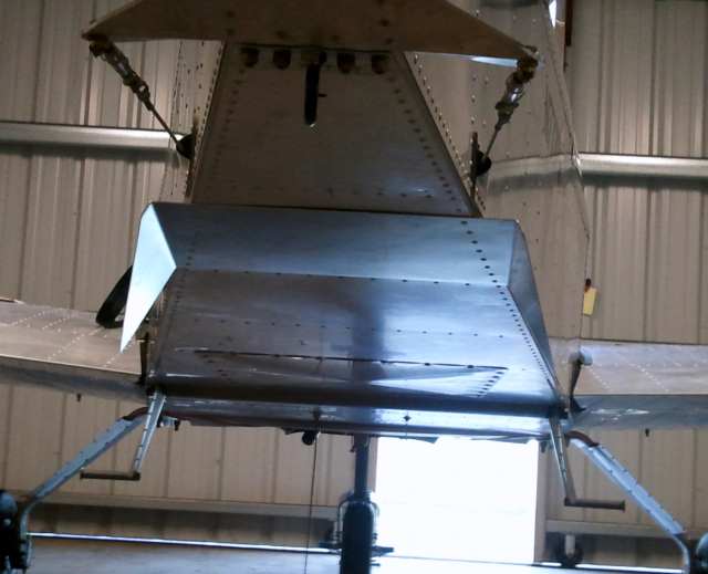

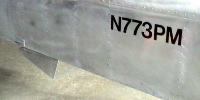

PostPosted: Mon Jun 04, 2012 9:10 am    Post subject: Flight test report - N773PM Reply with quote
Hi David,
Yes, I took a long hard look at slipping the XL.
The first thing I found (and mentioned in a recent message) is that there is no natural tendency for the XL to fly straight. Put another way there is no part of the fuselage that runs parallel to straight flight. The closest thing is the 22 degree angle formed by the fuselage sides at the aft end. This ignores any tendency for the full flying rudder to be aligned straight ahead by the plastic v-blocks at the bottom of the firewall.
So it seems the cross section the wind sees is just about the same when the fuselage is aligned straight ahead or +/- 11 degrees from straight. This suggests a slip that is less than 11 degrees to one side or the other has no noticeable effect. My findings in flight test agree with this theory. If you do a deep slip where the nose is more than 11 degrees off center then you will see increased drag - just as you indicated.
This is one of two flight characteristics resulting from the poor combination (in my opinion) of having no vertical stabilizer and no straight ahead sections of the fuselage. The other one is there is little or no yaw stability in straight and level flight. Within the +/- 11 degrees of straight this design has no natural tendency to straighten out when the yaw position is upset (as required by ASTM standard F2245). This is only a problem for S-LSA or E-LSA planes that are supposed to conform to this standard. E-AB planes can be anything the builder wants, but the claim I heard when I chose this design was that it conformed to the standard.
I added strakes to the fuselage bottom on my plane in an attempt to deal with this problem. It helped a little but didn't reach the point of making it stable in yaw. However, it did make it a little happier when flying straight and also had the effect of making small slips effective in making small increases in approach angle. I have found I like to use small slips either with or without flaps deployed to make the touchdown point a little shorter when my approach is a bit long.
I circulated pictures of my strakes a few months ago, but here are some pictures:
[img]cid:part1.06000205.04040605(at)att.net[/img]
[img]cid:part2.07010304.04020000(at)att.net[/img]
The single piece is made from .050 aluminum and the sides are misaligned (but balanced) so the air flowing over them keeps them pressed against the air flow. That way a small change in airflow increases the drag rather than causing the strakes to bend at first. The piece is attached to the bottom longerons using pre-existing rivet holes.
Let me point out that I am not a qualified aviation engineer. That means you can copy my design but you should not think it is properly engineered. You do so at your own risk.
My home field is reasonably long but has threshold displacements at both ends. The surrounding terrain is hilly so the winds are always swirling. We have three wind socks - one at each end and one in the middle of the runway - and they never point in the same direction. I almost miss those consistent cross winds that always seem to be haunting those mid-west runways. I spent several years flying in that area when I was stationed at SAC HQ near Omaha, Nebraska.
Best regards,
Paul
