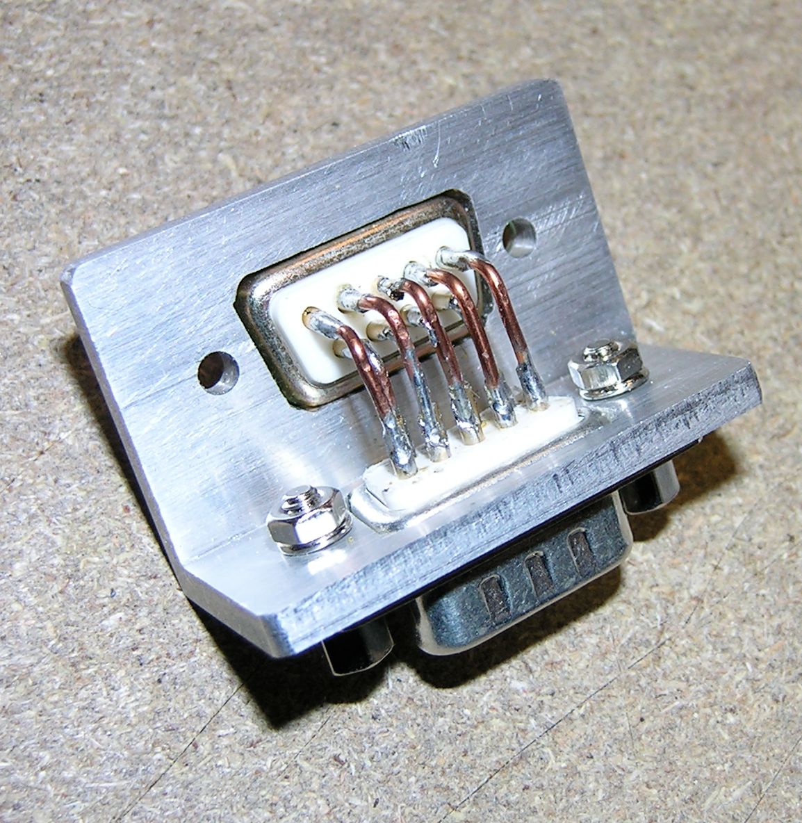

On 3 Jun 2012, at 15:18, Andrew Sarangan wrote:
Mod 76 says the Trutrak servo won't fit inside the thigh support compartment because the D-type connector is at the back of the servo and will stick out into the tunnel. So for the monowheel this won't work. I am a bit surprised that the connector cannot be modified somehow. But I don't have a Trutrak servo on hand to come up with a different plan. Does anyone have thoughts on this?
Andrew - here attached is a picture of my approach to the issue of the protruding D-type connector on the TruTrak servo for my wing-leveller installation. It's a short length of aluminium angle with holes made to suit male & female 9-way connectors. The interconnexions are made with solid copper wire (can't remember what gauge fitted the solder buckets nicely) and I will add an insulating cover before installation.

g-iani(at)ntlworld.com
PostPosted: Sun Jun 03, 2012 1:58 pm    Post subject: Trutrak or Trio Autopilot? Reply with quote
Andrew
I added the simplistic statement “the Trutrak servo won't fit inside the thigh support” when I wrote the Mod because I did not have a either a Mono to work with or the time to develop it. Here in the UK I have to work with a demanding regulator (the LAA) and would have had to demonstrate that what I was writing up really does work well.
What you have not seen yet is that Mod 76 issue 3. This adds the Dynon to the approved list. The Dynon servos will fit easily as the electronics are inside the gear box (not in a separate box on the side). I finished it months ago at the request of the LAA (as various builders wanted the Dynon) but Europa have yet to get round to publishing it.
Bud’s advice is good. There are various ways which the altitude hold can be achieved. Bud has referred to “attached the pitch servo to the tube behind the baggage bay”. It was decided that this was not really suitable for all aircraft but it has been approved as an individual Mod on one aircraft (and could be used again). I did the drawings for this mod which are attached. As you will see the servo used was a Trio but any one would fit as well. If this is of interest please contact me direct if you want more details.
