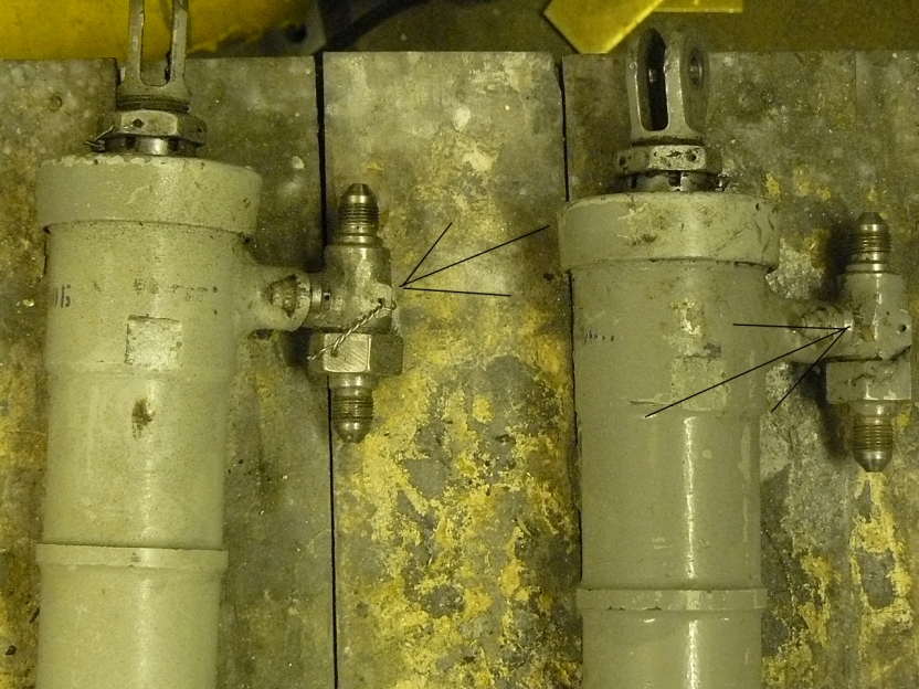

We emptied the emerg tank. The main tank pressure is up but nothing works.
We set the parking brake and moved the rudder to try and use the air but
nothing. Looks like the shuttle valve is stuck. Where is the shuttle valve?
Does anyone have any pictures of the components? Thanks
Gord

PostPosted: Tue May 29, 2012 3:55 am    Post subject: Gear problem Yak 50 Reply with quote
Questions from my mechanic Guy Doherty

PostPosted: Tue May 29, 2012 4:27 am    Post subject: Gear problem Yak 50 Reply with quote
The shuttle valve's internal ball moves only with air pressure from
whatever side (main or emergency) applies pressure to the shuttle
valve. Let's look at the system with no pressure at all in either the
main or emergency bottles. None of the components in the pneumatic
system have any pressure on them. That includes the shuttle valves.
Now lets fill the main and emergency bottles. Still none of the
components have any pressure on them because we have not yet opened the
main air valve or emergency air valve.
Now lets open the main air valve. Air pressure is applied to all of the
components in the system including the gear 'lifts' through actuator
shuttle valves. Shuttle valves are only on the DOWN side of the
actuators. Why? Because there are two systems that have the capability
to extend the gear; the main system and the emergency system. When the
air pressure is placed on the shuttle valve, the ball inside the shuttle
valve is moved to the opposite side (internally) of the shuttle valve.
This blocks the air pressure from the emergency system from entering the
actuator. The ball stays in that position until the emergency air valve
is opened. But the ball will not move unless there is no air pressure
from the opposite side pressing against it.
Now with the airplane on jacks lets to do an emergency gear extension
test. To do this, we must first remove the pressure from the UP side of
the actuator. This is done by moving the gear selector to the neutral
position. That is the 'woosh' sound you hear when you move the gear
selector to neutral. Now there is no air pressure in the actuator and
no pressure from the main system on the shuttle valve. Open the
emergency air valve and the gear moves to the down position VERY hard.
What happened when you opened the emergency air valve was, air pressure
was sent to the shuttle valve moving the little ball inside to the
opposite side, thus blocking the main air side of the shuttle valve.
Now here's the main point of this discussion. If you don't remove the
pressure from the shuttle valve, the air pressure will hold the ball in
the position it is presently in and BLOCK any air from the main system
side from being able to retract the gear.
That is why we have to first deplete all the air from the system
components before we attempt to retract and extend the gear from the
main system side. We do this with the main and emergency air off and by
squeezing the brake handle and if equipped, moving the flaps, until
there is no air left in the system. No 'woosh' sound when the brake
handle is released. Then when you open the main air valve, the shuttle
valve moves back into the 'normal' position, blocking the emergency side
of the shuttle valve. Now the gear should retract and extend normally.
Hope this helps.

Hello,
the shuttle valves are mounted on the gear actuators, see photo. Dennis explained the logics in the system perfectly.
Vic

There is a shuttle valve for each of the actuators. Thus, 2 of them.
Look at the top of the gear actuator. This is the end opposite the
chrome shaft that moves in and out to retract and extend the gear. The
is the DOWN end of the actuator. Look for a line or small component in
the line either on or close to the actuator. This is the shuttle valve.
