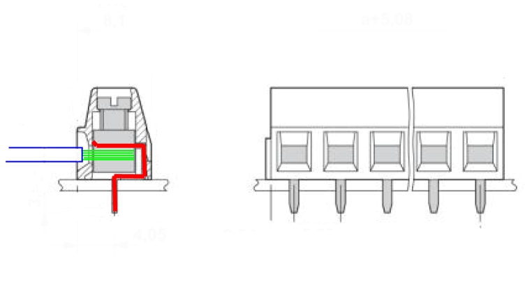

Had a chat with Brad Dement about an hour ago to
confirm validity of my earlier post. Perhaps I can
offer a clarification of the science behind this relatively
new wire termination technology.
Clamping solid wires under screw heads and nuts or between
washers is a legacy technique going back a century or more.
When stranded wire became the material of choice for ease
of installation and vibration resistance, getting a good
clamp under a rotating fastener became problematic. An ol'
gray beard electrician once advised me to put a counter clockwise
twist on strands and them wrap the wire around a stud in a
clockwise direction so that rotational motion of the fasteners
tended to tighten the twist as opposed to unwinding it. This
technique recognized the fact that stranded wire was really
a different animal for achieving enduring connections.
Then folks like AMP, Molex, T&B came along and figured out
ways to crimp a terminal onto a stranded wire in a way that
essentially turned terminal and wire into a single piece
of metal.
But the guys who made a living figuring out ways to connect
wires came up with a new idea which I've illustrated below.
The goal is to make a high pressure, tightly constrained joining
of wire strands (green) with an electrical conductor within
the assembly (red). Design goals included taking both the
screw and the mechanical structure around the joint out of
the current pathway. It would also be nice if the end of
the screw did scrub against the strands during rotation.
[img]cid:.0[/img]
What you see above is a generalization of the elegant solution.
Stranded wires are captive within the 'box' along with a large
area conductor driven into intimate contact with the strands
by screw pressure. The end of the screw never touches the
strands. Further, the box around the joint and the screw
are rather robust. Brad tells me that he has put a lot of
torque to these seemingly small screws without stripping
the threads or twisting the head off.
So what appears to be a joining process that favors
solid wire, the technique actually accommodates stranded
wires equally well . . . if not better. The magic happens
by combining high pressure to a constrained bundle of
strands and keeping the numbers of joints in the power
path to a minimum. The forces are less than for a crimped
joint . . . the strands are minimally deformed and certainly
not gas-tight with the red conductor . . . but it's adequate
to the task. No value is added by converting the strands
into a 'solid' conductor.
Pretty slick.
That takes care of electrical issues . . . and in the
stationary environment is probably sufficient. In a high
vibration environment, the installation is not complete until
the bundle coming off the terminal strip is firmly constrained
in a closely co-located clamp.
