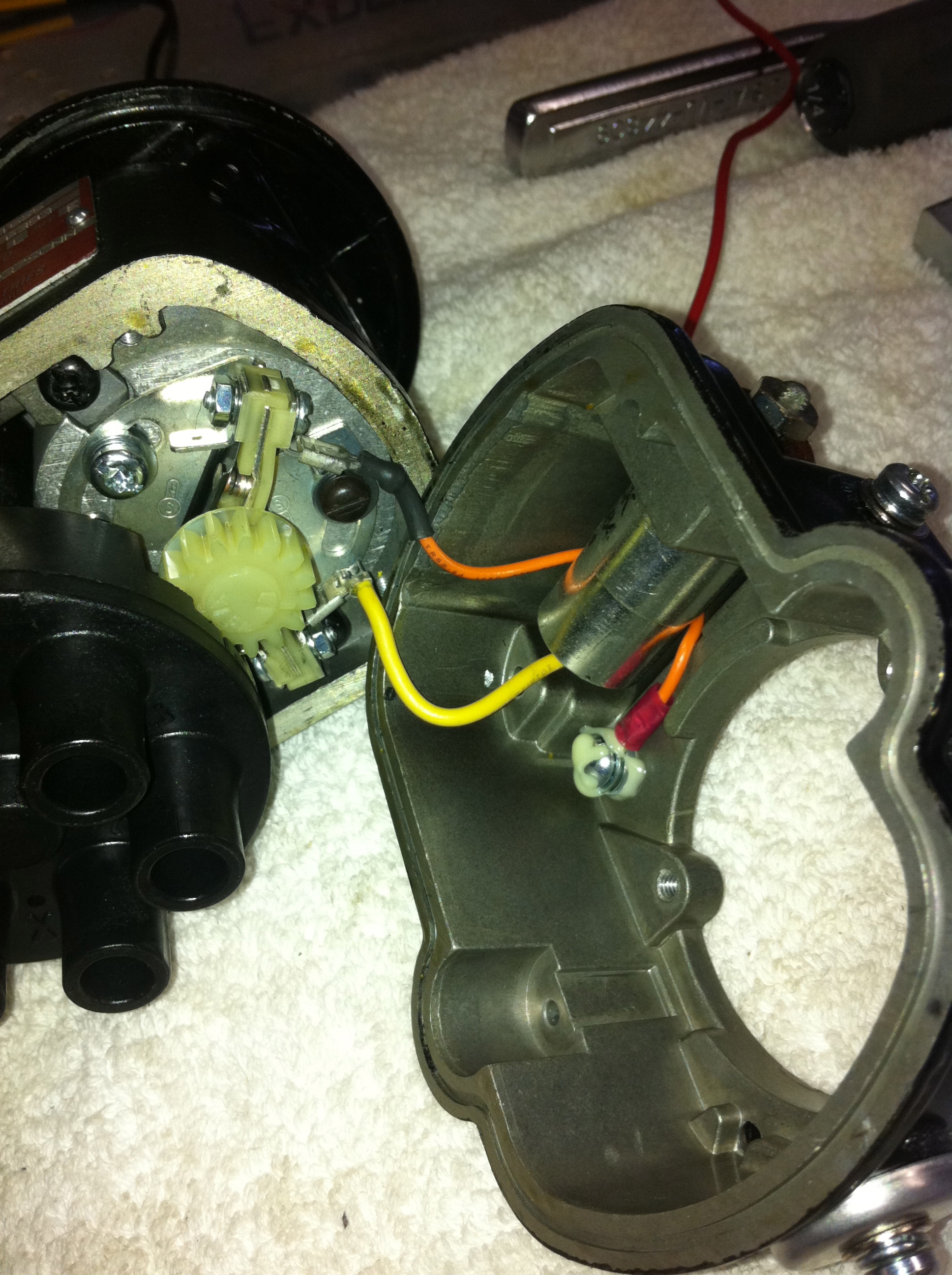

I am in Albany, OR, with a mag problem. Lightspeed works fine but The new Slick with only 20 hours on it is not sparking. Opened it up and everything looks fine, points open and close, rotor turns, and the brush looks ok but no spark. Even got brave and held it when I. Turned it over but no spark. Only good thing is there are several RV's here and they are a great help. Any ideas would be appreciated.

Can you get an ohmmeter across the coil? I don't know what it should read but "infinity" is wrong.
I think your "hold it in your hand test" will not work, even with a good mag, unless you have impulse couplings. The standard IO-540 sold by Vans does not have them, it uses Slick Start instead.
Prior to flying I pulled all the plugs so there was no compression; laid one plug, hooked up, on a good ground; and then rotated the prop as fast as I could by hand. With no compression that's pretty fast. But it wasn't fast enough to generate a spark.
(If the battery dies so much that the Slick start won't run, you can't hand prop this engine).

Try disconnecting the P-Lead. Maybe it's shorted to ground somewhere.
Just remember the mag will be hot.

A shorted Ground or P lead can create a lower resistance path.  I have seen two different Vans/Aircraft Spruce switches go "tango uniform".

I have also had a P lead internally shorting to the shield, causing a dead mag.

Early on, I think for my second flight, I went to start the engine and it would not fire. I had started the engine many times before and had flown once. Pulled plugs and found no spark when cranking. Pulled the mag and found the retard contact point terminal had worn through and shorted to the side of the mag case. This was hard to spot at first and took very close inspection. I had to bend the wire slightly to see the shine of the terminal metal through the heat shrink. You can see in the photo the connector heat shrink on the orange wire touching the case. I am sure vibration caused it to wear through the heat shrink and grounded it to the case. I reinstalled the connector with new heat shrink and bent the tab slightly to clear the case. This is how it came as installed by Slick.
After the repair she fired right up. So far so good.

The guys here at Albany have been a big help. My mag was a new (20 hours) Slick 6351 impulse coupled, non-retard, left rotation, 20 degree lag. With the mag out of the plane there was no spark. We found another mag and started swapping parts eventually swapping out the coil, condenser, and the rotor. Nome of the parts made my mag work but all of my parts worked fine in another mag. Assuming we haven't confused ourselves that seems strange. I have located an A&P who will look at it tomorrow. Many thanks for those of you who have offered advice and/or offered to send a mag. So far the problem is still with me but tomorrow is another day. Weather her in IMC in the mornings anyway so maybe I will be good to go by the time the weather improves tomorrow. Again, thanks everyone.

P-lead is ok, funny thing is that all the components work in another mag. Unfortunately, that mag won't work on my engine!
