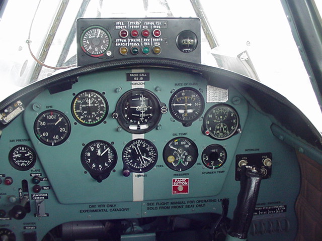

PostPosted: Sun May 20, 2012 12:15 pm    Post subject: Solo startup and shutdown, re front/rear magnetos Reply with quote
Assuming you have a CJ, look at the attached photo. See the toggle
switch just above the mag switch? In the UP position, the mag switch in
the front cockpit has control. In the DOWN position the mag switch in
the rear cockpit has control. It should be left in the UP position.
Same is true for the Yak 52 except the 52's toggle switch is above the
gear selector and has a metal 'guard' on both sides.
Dennis

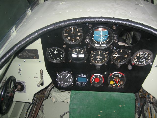

PostPosted: Sun May 20, 2012 12:21 pm    Post subject: Solo startup and shutdown, re front/rear magnetos Reply with quote
If it's a Yak 52, look at the attached photo. Next to the gear selector
at about the 4 o'clock position is a toggle switch with metal tabs on
each side bent in over the toggle switch. Bending the side tabs
somewhat prevents accidental movement of the toggle switch.
Dennis

Dennis and Byron, you guys are kickass... absolutely correct. I couldn't stand it and drove all the way back to the airport (hope I get a hangar closer to home one of these days) and checked out the Savarese photography.
Way down in the instructor position corner is what was shown on the photos - "zazhiganiye kabina 1 + 2", which of course means "ignition, cockpits 1 + 2," right ?
Thanks to all for the input - Matronics folks are the good guys.
