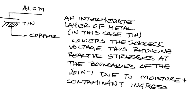

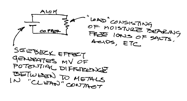

PostPosted: Sun May 20, 2012 7:48 am    Post subject: Anti Corrosive Zinc Paste Reply with quote
There are several posts from people about this, and I see two more that I haven't read. Let me see what they say and hopefully one of them will stand out on a recommended good grease at a good price and readily available.
I would suggest the use of ductile sealants on joints that
are exposed to most severe combinations of contaminants+water+
heat. Battery terminals come to mind. Joints that are made up
once and expected to run the lifetime of the airplane (crimped
terminals, fat-wire connections to accessories, busses, etc)
and not splashed or gassed are generally fine without added
insurance.
While I was working at Cessna, I recall an optional 'corrosion
resistant' treatment that was offered to individuals who lived
on the coasts, and owners of planes on floats or agricultural
spray planes. Over the years, there have been numerous spray-
on treatments for the interior surfaces of aluminum airplanes
with a notion of slowing corrosion. But all of these offsets
were directed at structural corrosion issues as opposed to
the make up of a joint between two conductors in the electrical
system.
Intrusion of conductive moisture is antagonistic to the
copper/aluminum joint right at the edges of the joint. Usually
right under the terminal flag, out of sight but also not gas-
tight to the environment.
[img]cid:.0[/img]
For all the concerns about fending off oxidation of metals
on the aircraft structure, I don't recall ever reading about
a generalized treatment of electrical components beyond the
use of tin plated terminals to take a ground wire down to
an aluminum skin. The value of this process is illustrated
here:
[img]cid:.1[/img]
Adding the layer of tin to the copper by plating insures
gas-tightness between the copper and tin but the mechanical
limitations of getting gas tightness between tin and aluminum
are unchanged . . . the advantage of this process is that the
Seebeck voltage developed between aluminum-tin thermocouple
is lower than aluminum-copper . . . hence the rate of corrosion
in the presence of dirty moisture is reduced. It's still not
zero but it is smaller. Virtually any, viscous, non-conductive
material in this space is an effective deterrent to the ingress
of dirty moisture.
