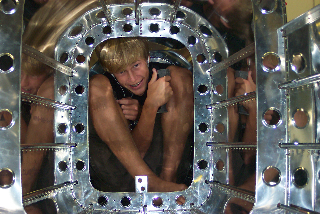

Hanging it would only make it more difficult. You'll want to build the tailcne on a flat bench.  No jig.
What worked well for me was large back riveting plate. Mine was about 24" x 12" x 1/4" (guesstimate) from a local scap yard. This was laid on the bench and scrap 1/4" ply from the crate was used to fit around the plate to provide a folate surface for the cone to lie on.
With that setup, you can  backrivet 80% or more of rivets flat on the bench. That makes high quality results very easy. A short and long backrivet set is needed.
For many of the rivets that can't be backriveted flat on the bench, you can use a back rivet bucking bar (larger mushroom shaped) and bang the rivets with the backrivet set from inside the cone.  Again, most of this is easily done laying on a flat bench.
I considered most riveting that required crawling in the cone after it was hung the result of planning oversights. Everything done on the bench was done single handed.

I should add that for the clecoing and match drilling you need saw horses or something to raise cone off the bench to clear the clecos. It becomes pretty obvious as you proceed.
Yes, the accuracy of the CNC stuff is simply amazing. It just all fits despite your best efforts.

PostPosted: Fri May 18, 2012 8:52 am    Post subject: Building the tail cone Reply with quote
It helps to have one of these:
[img]cid:92CBDAD4-BCE5-4ACB-9391-B457C8F9FA1F[/img]

PostPosted: Fri May 18, 2012 9:25 am    Post subject: Building the tail cone Reply with quote
I strongly suggest renting one of those. There are many maintenance issues associated with ownership.
Robin

taildragon(at)msn.com
PostPosted: Fri May 18, 2012 1:37 pm    Post subject: Building the tail cone Reply with quote
<?xml:namespace prefix="v" /><?xml:namespace prefix="o" /><![endif]--> Couldn't have done it without mine!
Roger
