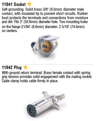

Unfortunately, no. But thanks for looking! The
"Piper" style ground power plug is a Cole-Hersee
product
[img]cid:7.1.0.9.0.20120516082536.0037fa08(at)aeroelectric.com.0[/img]
. . . first popularized by Piper for aircraft and
adopted by quite a few others. In fact so many that
FBO ground power carts are often fitted with mating
plugs.
The Aerostart product didn't seem to catch on and
only made it onto a few production models. It's sort
of the 'beta-max' of ground power connectors. Perfectly
good and perhaps even superior to the truck connector
but alas . . . for lack of a blessing and support by
a major manufacturer . . . it's toe hold in the marketplace
was tenuous at best.
I think if I owned an airplane fitted with an Aerostart,
I'd convert it to something more popular.
