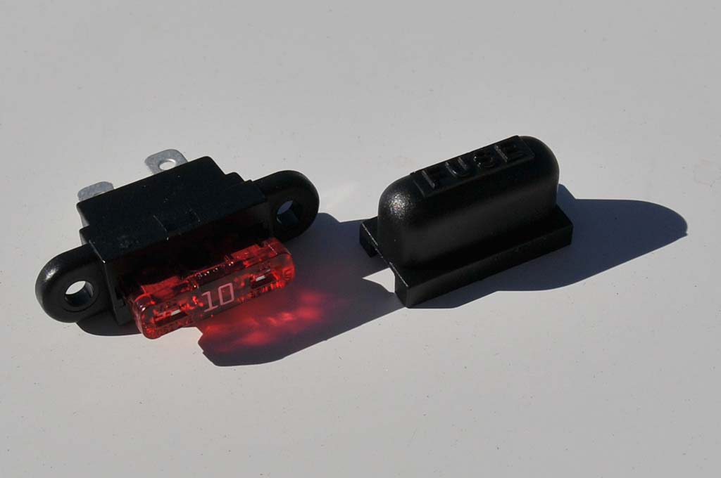

On several occasions, like today, I've wanted to
incorporate a hard-mounted ATC fuse into a chassis
assembly. There are probably surface mounted holders
out there . . . just didn't have one in the junk-bins.
I'll refer the interested readers to the fuseholder
pictures at:
http://tinyurl.com/7sguf9t
The ATC_on_a_Bracket series shows what I discovered
when I ground off the "inert" meat on the fuse holders
I have on hand. This exploration revealed that for this
particular device, there was .400" of inert plastic on
butt side of the fuse holder.
A few minutes work in the shop produced a bracket and
attach method that solved the problem du jour. Thought
I'd add it to the shared AeroElectric bag of tricks . . .
mapratherid(at)gmail.com

Not all holders have that much free plastic and you'll
want to sand away the proposed mounting meat to make
sure no fuse wiring extends into the boss.
I considered just bonding this holder to the bracket but
wasn't sure about storage temperature extremes. Decided
to bond it to fixture and then re-enforce the bond
with screws.

The holder body is solid plastic. I suppose you
could use self tapping screws in the plastic . . .
but machine nuts on a screw are much more secure.
You can thread-lock them with super glue.

90 degree difference in orientation, but another option is:
http://www.jaycar.com.au/productView.asp?ID=SZ2046
Kind regards, Stu

Thanks Stu, and these have the added benefit of not having to splice into
pre-assembled PVC lead wires.
Bob McC

That's a great idea- you could also cut away the little circular bits on the
side and gang the fuses in a row...
