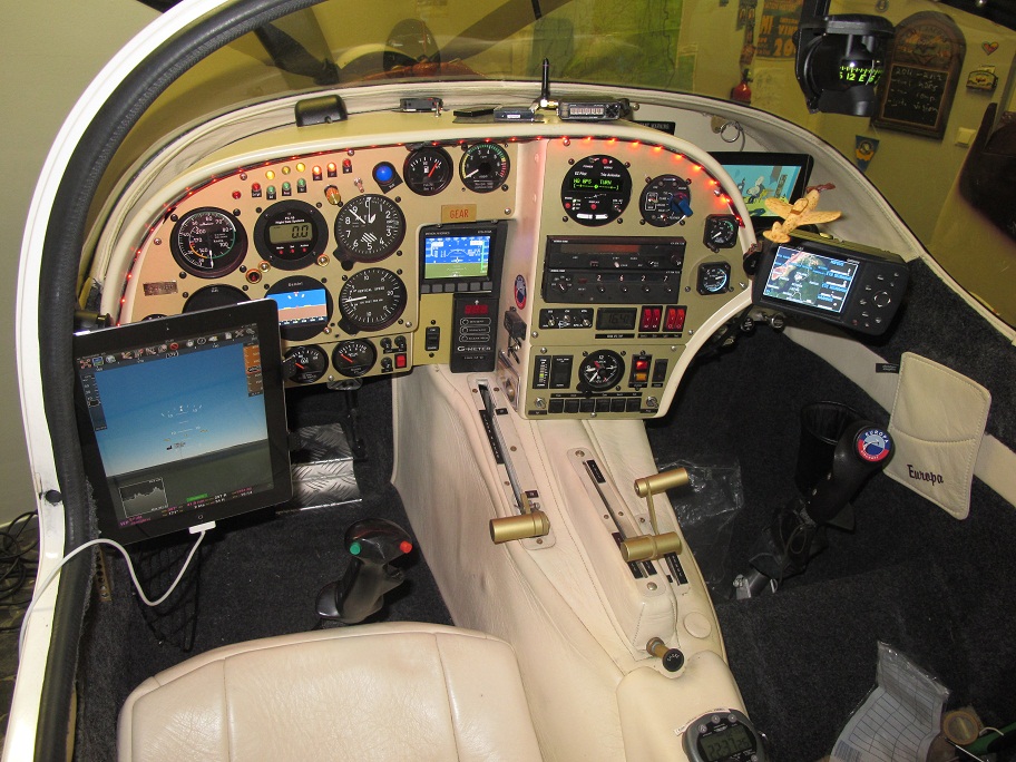

PostPosted: Tue May 15, 2012 12:45 am    Post subject: ipad mount Reply with quote
It depends on where you want to mount it really - there are many types of
mounts - flat, angle, arm, ISO mount.
I've used an ISO mount and mounted it in the middle panel - see photo
attached.
I highly recommend anti-glare screen, made a MASSIVE difference! (put on
after this photo)
I'm still trying to find somewhere to stick my 'standby' garmin 496 that
doesn't block the screen.

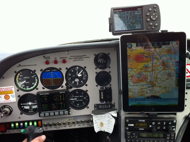

PostPosted: Tue May 15, 2012 1:21 am    Post subject: ipad mount Reply with quote
We use a RAM-mount on a kneecap fixed on the panel that you can see on the
picture on the upright corner. I shall provide one with the iPad installed
but not before next week after. Almost 100 hours with no noticeable issue,
but the fact that the passenger have no access to intercom buttons (just
under the kneecap) from his seat.
Max Cointe

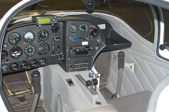

PostPosted: Tue May 15, 2012 1:28 am    Post subject: ipad mount Reply with quote
Hi Richard,
how about this?
The camera was aproximately there where is my my
head when flying.
The Master ASI is well visible but a skid/ball and
panelīs lower port corner not (there are some
fuses, switches and a key),
In the other hand IPadīs mount is easily
adjustable so I can turn it 90 degrees if I wanna
see whole panel (but then IPad is not visible).
Notice: this configuration with also a new
TruTrakīs Gemini ADI with TCW`s IBBS and Garminīs
35HVS and FDSīs FC-10 fuel comp with GPS and only
ONE fuel transducer has not been in the air yet
but tomorrow it will. Wish me luck.
Cheers, Raimo Toivio

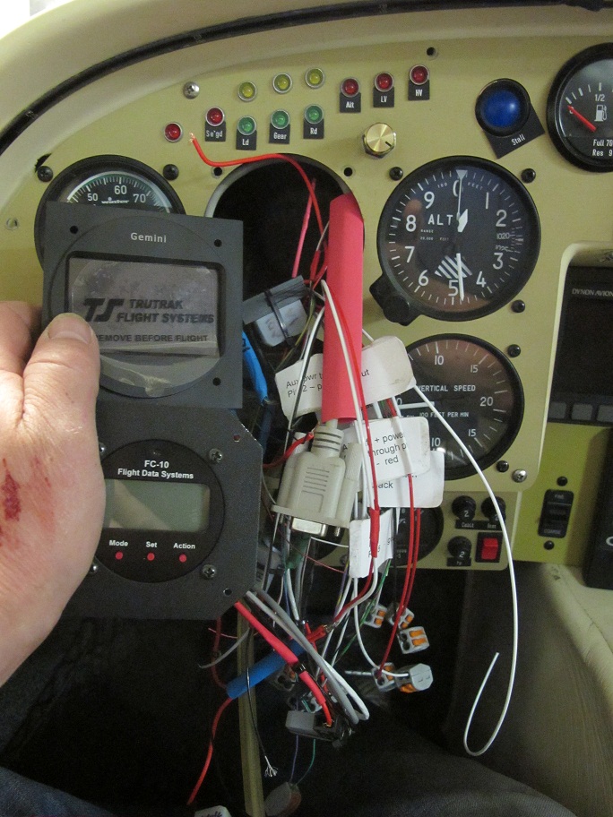

PostPosted: Tue May 15, 2012 3:02 am    Post subject: ipad mount Reply with quote
Hi Gerry,
thanks. I certainly did - this was the situation
during 10th of May (that red is some blood in my
hand - those 3 1/8" holes are a bit tight to
penetrate both hands together towards a firewall -
I envy those panel builders who have an RV-style
direct access and a direct vision to the panel
back side).
I soldered all the wire joints and there were more
than 100 of them. Of course I have to move one
switch (IBBS master) to another place because of
space problems and of course ADI was planned to
instal up and fuel comp down but because of a lack
of space between ASI and ALT they went vice versa
and of course those wires from rpm gauge blow out
(not soldered - those stupid pins only) and it
took 6 hours to fish them back home and of course
also some minor problems like Geminiīs wiring
diagram REV A was uncompleted and I had to call
couple of times to Zachs and Lucas to TruTrak and
made a REV B but finally then it worked flawlessly
without smoke since a very first try to give pwr
them. Gemini is also connected to the pitot/static
and now I have a little worry have I managed to
make tight enough joints - that is something which
will be tested tomorrow as are also ALL the rubber
parts front of the firewall - they are brand new
and a fuel system front of the wire wall have a
totally new configuration because of added single
FT-60 "red cube" (I have a fuel return line still
in use).
It is a funny, painful and in some cases also a
dangerous EXP-sickness (to have a kind of a
compulsion to update regularly panel) but always
so fascinating. And those old, heavy and
mechanical gyros AH and DG are finally out.
Will report. And make a dozen new placards...
Cheers, Raimo
