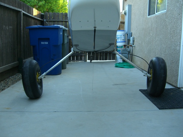

After installing replacement (not new) gear legs and gear/axle fittings on my early Firestar, both my camber and caster are incorrect...  I used the existing mounting holes not realizing that apparently the holes are drilled by the installer, not Kolb and consequently, no two Kolbs will be alike...  Now I need to move the gear up further in the socket and drill new holes...
Question is, what is the criteria for aligning the gear?...  If a 5-6' 5/8" rod is slid in the axle sockets so that the axles are in alignment and then the mounting holes drilled, is that sufficient?...
Thanx...
David

That will do ok. Stick some weight in the airplane first because
angles change with
load. I prefer to locate the imaginary centerline of the plane on the
garage floor,
about 10' in front, then align a chalk line down the tire sidewall to
the corresponding
mark ten feet out. -Then drill either the hole fixing the leg in the
airframe
-or in the axle adapter. Perfectly parallel wheels will track just
fine.

A simple method that I use, is to slide a piece of tubing through one axle socket out through the other axle socket. A piece of rigid wall conduit works fine.
This will align the axles to the airframe.
Drill your mounting holes.
I always set camber at 7 degrees with the weight of the aircraft on the wheels.
When you set your skinny or fat butt in the aircraft you have about 0 to 2 degrees camber.
I always use 0 degrees toe in or toe out.
conduit works fine.
the wheels.
Jim Hauck
On 6/5/2006 10:48:09 AM, David Lehman (david(at)davidlehman.net) wrote:
> Thanx Robert...
> That looks like the easiest way to do it...
> DVD
> On 6/5/06, robert bean <slyck(at)frontiernet.net  [link:
> mailto:slyck(at)frontiernet.net]> wrote:That will do ok.  Stick some
weight
> angles change with
the
> garage floor,
> about
> the corresponding
> airframe
> fine.
5-6'
> 5/8"
David.Lehman
Posts: 265
Location: "Lovely" Fresno CA
PostPosted: Mon Jun 05, 2006 6:58 pm    Post subject: ADjustme of Wheel Camber on a FireFly Reply with quote
Thanx Jack and Jim...
I used a pickup truck bed partition, the tubular affair that you twist to
tighten against the sides of the bed, fortunately for me the ends are 5/8..
ô¿ô
