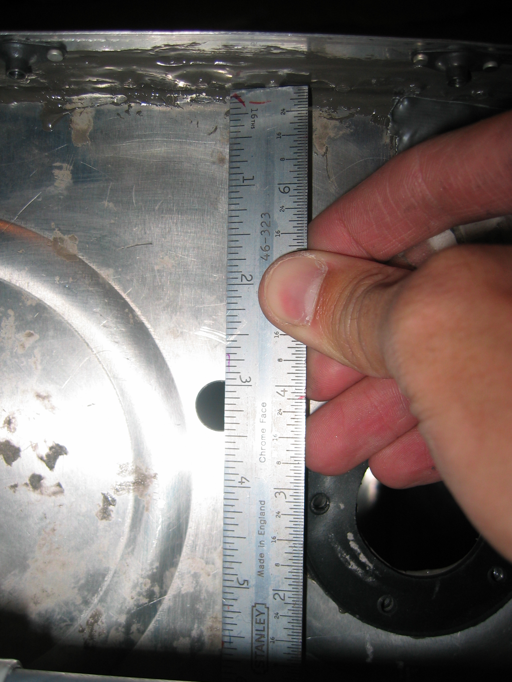

Attached is a photo that Scott Schmidt provided me several years ago. I put
mine in the same location.

PostPosted: Fri May 04, 2012 7:02 pm    Post subject: Low Fuel Sensor Location Reply with quote
Thanks Bob,
I'm planning to put my sensor in the same position fore and aft but probably an inch or so lower to get warning at about 4 1/2 gal useable per my calculations. Do you know what fuel level corresponds to the sensor location in the picture you attached?

PostPosted: Sat May 05, 2012 1:22 am    Post subject: Low Fuel Sensor Location Reply with quote
My memory seems to recall about five gallons, but I'm sure that Scott can share his results since he's been flying for awhile. I'm about 90 days away from putting fuel in the tanks.

PostPosted: Mon May 07, 2012 1:36 am    Post subject: Low Fuel Sensor Location Reply with quote
From what I recall in conversations with Scott, it should be about 5 gallons. I made those mods about three years ago, so the memory is a little fuzzy. I will test in July when I first put fuel in the tanks.

PostPosted: Mon May 07, 2012 11:30 am    Post subject: Low Fuel Sensor Location Reply with quote
I can confirm. I used Scott's measurements, and i got the optical
warning at 5 gallons in level flight the other day. However, with
turbulence, it can warn with as high as 10 gallons.

40950(at)rv10.net
PostPosted: Mon May 07, 2012 4:04 pm    Post subject: Low Fuel Sensor Location Reply with quote
Bob,
Thanks! That is very close to the position I have chosen for which my calculations show 4.7 gal total or an estimate of 4.4 gal useable (sucking air). Jae reports his sensor on at 5 gal in level flight using the same Scott Schmidt location.
Tom

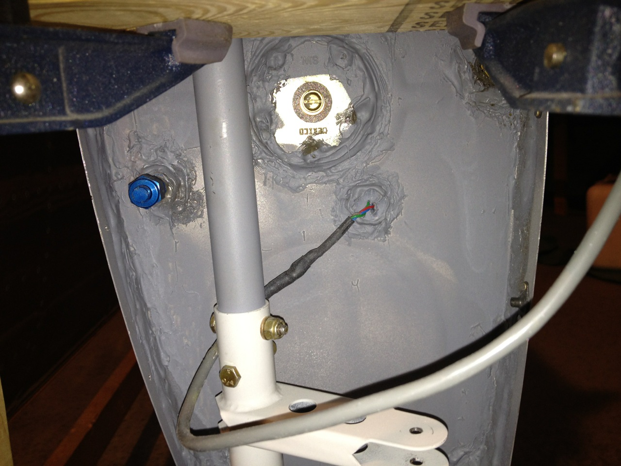

Begin forwarded message:
From: Bob Leffler <bob(at)thelefflers.com (bob(at)thelefflers.com)>
Subject: Fuel sensor
Date: May 7, 2012 4:43:50 PM CDT
To: Tom Koelzer <40950(at)rv10.net (40950(at)rv10.net)>
The bottom is on the right. This is a photo of my right wing.
[img]cid:6802CC7F-F6B3-4F37-B899-C6BD726E952B[/img]
 Filesize:  264.85 KB
 Viewed:  6811 Time(s)
