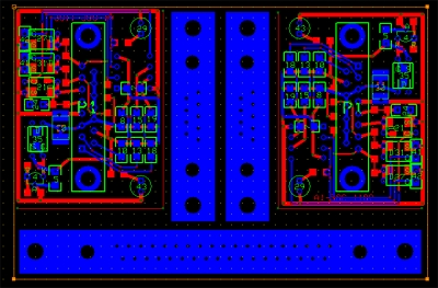

Some background on the decisions that went
into satisfaction of design goals:
I started with the following ideas for
crafting the configuration I published:
1. Use the already developed package based
on Polycase enclosure and D15 connector. I
have cases and lids already cut to accept the
connector. Of course, this sets the boundaries
on the ECB.
2. Use simple on-off-on toggle switch to achieve
OFF-WW-ON control functionality. Easily handled
with software logic.
3. Minimum parts count.
4. Minimum variety of parts.
5. Maximize heat-sink copper for the FETs
6. Add some functional indictors for
as-development tools (a couple of LEDs)
so that bench testing of software needs only
a switch and power supply.
Parts selection was pretty easy. As one
can see from the schematic, all resistors
and capacitors are the same value. This
makes it easier to order, stock, and
install with minimized error. The only
parts that required any "calculation for
performance" was the voltage divider for
the power supply (exact value not critical
and they only needed to be equal). And
the series resistor for the shunt regulator.
The calculated optimum value could be achieved
by paralleling 4 of the common bill of materials
value. 4.99K / 4 gives us about 1200 ohms
at better than 1 watt because the heat doesn't
come out of a single device . . . but is spread
over larger area.
The other values go to transient immunity.
Two standard practice bypass capacitors on supply
rails, two capacitors and two transorbs
protecting fragile silicon from stuff conducted in
on the ship's wiring.
This is a good example of what my cohorts
at HBC called a "cotton ball" . . . very
non-critical components (tells us that
drifts in performance due to component
tolerance/drift are insignificant). The
thought processes that go toward component
selection are pretty ho-hum.
Not to take away from the ultimate
functionality of the assembly. Once the
silicon is safely wrapped in environmental
cotton, the magic poured into the source
code is relatively unrestricted.
A similar philosophy was adopted for the
'do-lots' board from which this project
evolved. Figure out a way to wrap an 8-pin
PIC up in a deep sea diving suit and then
teach it how to sing, dance and do dishes.
I'll order boards today. As Eric mentioned,
ExpressPCB doesn't fuss about what is on a
miniboard (3 pieces returned in 3 days for
$70). Each mini-board will give us two
finished boards with a couple of avionics
ground bus boards thrown in on the side . . .
sorta like this:
[img]cid:.0[/img]
So we'll end up with 6 boards for the development
work at a cost of just over $11 each and turned
around in 3 days. If I sell some avionics grounds
with the 'residuals' then the out-of-pocket development
costs go down.

On page 3 Pin 6 of the micro is being used as GP1 in this application.
On page 3 Pin 7 of the micro is being used as GP0 in this application.
Yeah, I had a number of loose ends dangling out. I've
updated the data package with more organized Bill of Materials
and some expanded information.
http://tinyurl.com/6lh769o
and a couple of questions...
1. Pin 12 on the d-sub connector seems to be unused but also shown
differently than the other pins on the page 1 drawings. Is this
a convention of some sort?
Fixed that.
2. Looking at the PIC12F683 data sheet there are some confusing
instructions on using MCLR with Power on Reset but I think that
Pin 4 could be left unconnected for this application or
used for another purpose since there is no external reset circuit.
What is your reading on this?

Your suggestion sparked some consideration of making this board capable of doing the functions presently proposed for the 9024 4-function module.
By removing two pull-ups 11 and 14 and adding two divider resistors 26 and 27, these inputs can be shifted from discrete commands to analog inputs. By taking pins 4 and 3 out to the d-sub connector, the user selection of functionality can be accomplished the jumpers in the plug.
I've added another dash number to the ECB assembly to reflect this potential. I'll suggest we leave the 4-function module on the back-burner until the current wig-wag design is gelled . . . but I'm considering putting the 4-function module into the Open Source program too. It would be nice to get that product into the catalogs and this seems like the shortest path to that goal. As it is, it meets my needs for a wig-wag module but I can see a software
option that might be useful for users with other configurations of lights.

Okay, peek at P2. I've got some work to do in Wichita this weekend. I'll take a copy to pray over with a target for ordering boards on Monday

PostPosted: Sun Apr 22, 2012 6:33 am    Post subject: Re: OS Wig-Wag Project Reply with quote
Bob,
Took a look at the P2 version and it looks good. Only noticed an issue
on page 3 with the d-sub pins. Pin 11 is listed twice (one should be
Pin 10) and Pin 2 is missing (2nd line to the power bus).
I will use the P2 to continue with the software for the wig-wag. I should
have something available later this week to use for testing with the
hardware.
Greg McHugh

Very good. I'll order boards today when I get back
