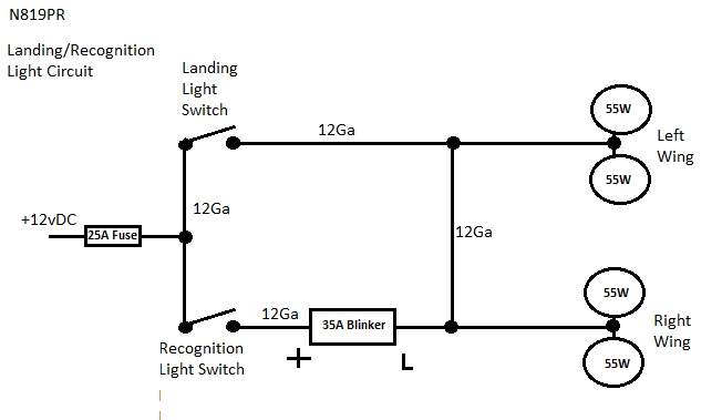

By adding a Bussman 244 heavy duty flasher, a little re-wiring of my airplanes landing/taxi light circuit gave me a good recognition light system for the airplane. Now depending on which switch I throw, all 4 of my landing/taxi lights either flash or light up. With all 4 lights blinking, the airplane's visibility is greatly increased during the day. All I had to buy was the 25A fuse and the Bussmann 244 flasher which ran just under $15.00 for the whole setup.
Here is a picture of the circuit and how I did the wiring.
 [img]cid:ii_1373eb304536cc03[/img]
