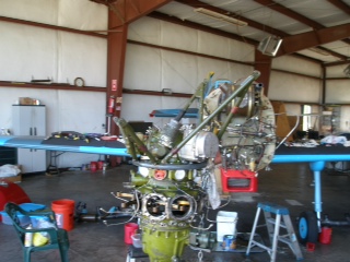

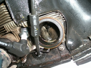

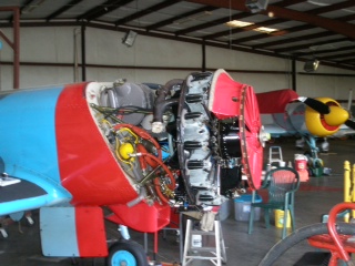

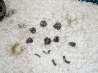

Morning to you also Brad...more like early Monday morning now down under.
I can speculate on what caused the loss of power but the tear down will answer the majority of your questions. Having gone through an engine issue one year ago now, the obvious as speculated was not the answer. They were close but no banana. Wait for the tear down. The answers will be forthcoming. Tough to do in this age of instant gratification for sure but the answer at tear down may surprise you. It did for me.
Glad all walked away without injury.
From there to this, it was not what I thought as revealed by the tear down. It was maliciously introduced FOD. Bottom line, it will be a better plane when done as yours will be also.
Good luck.
