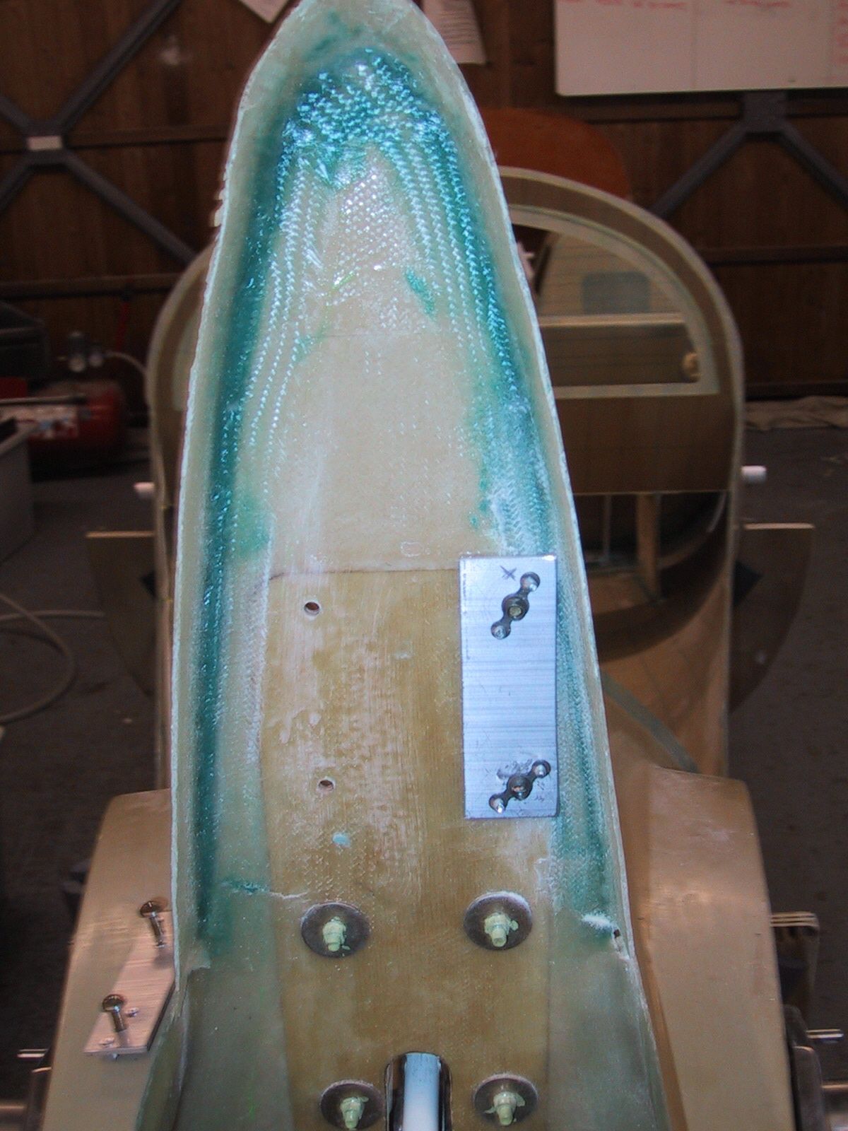

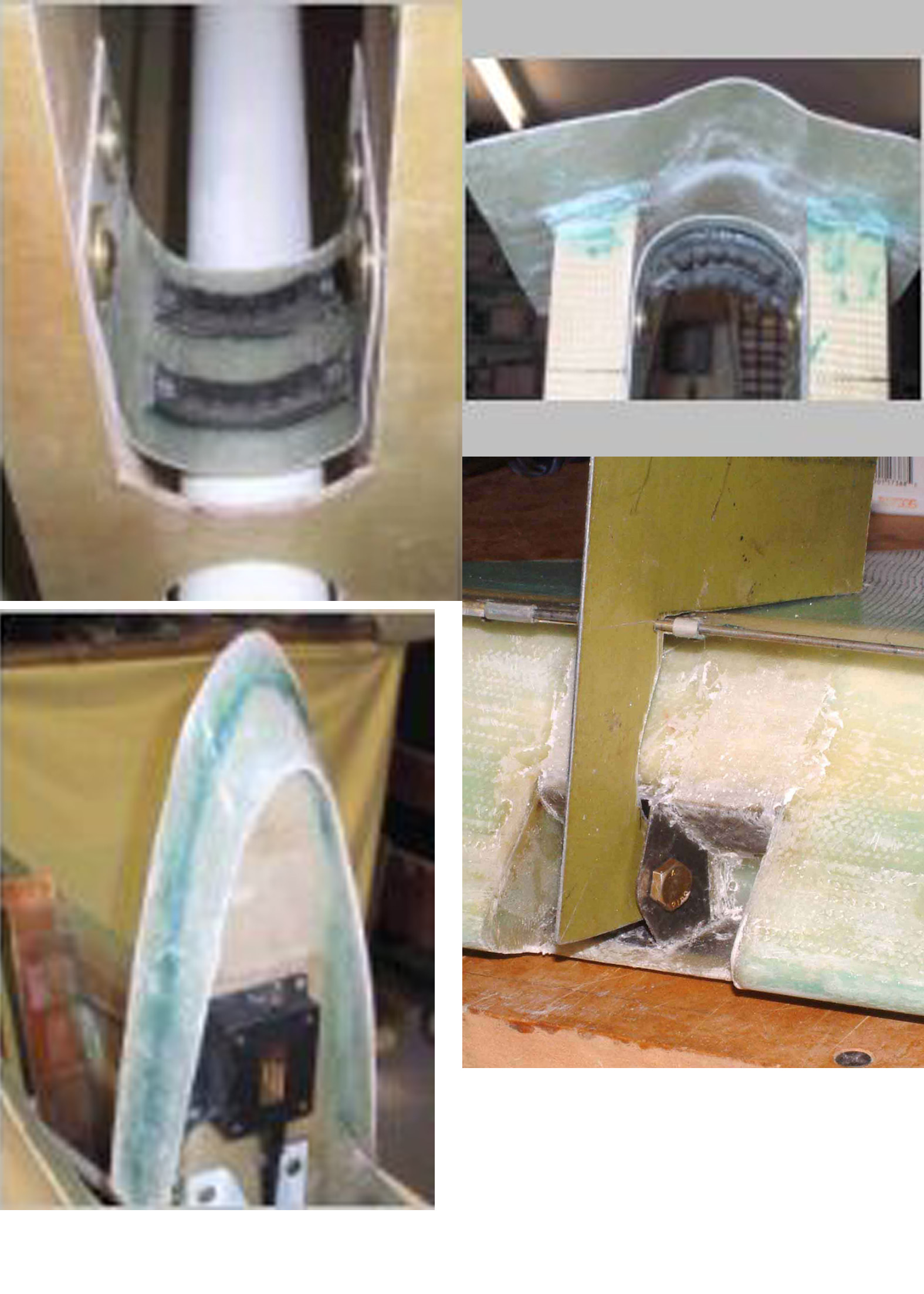

PostPosted: Wed Apr 18, 2012 6:28 am    Post subject: mass balance stop and pushrod containment assembly Reply with quote
Rowland
have a look at these pix. Tempo attach the splash mouldings with the top clecoed on then finish the assembly with the top off.

g-iani(at)ntlworld.com
PostPosted: Wed Apr 18, 2012 8:12 am    Post subject: mass balance stop and pushrod containment assembly Reply with quote
Rowland
I have the pictures (similar to what Graham has sent) for what you want ready to go up on the web site. They really need a written description of the method which I have not yet had time to write but I will get them in as soon as I can.
