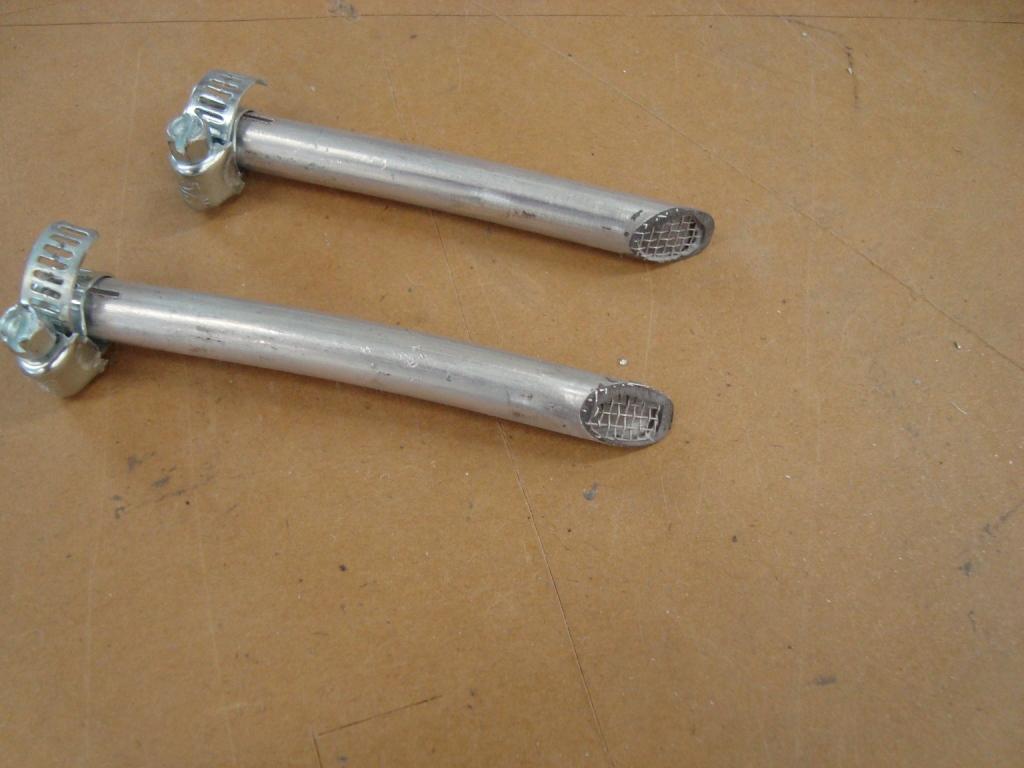

Here is a simple way to keep mud-dabbers from clogging your fuel vent.  I think more than one RV has collapsed a fuel tank from a clogged vent.
Take a few inches of 3/8” aluminum tubing, cut one end at 45 degrees or so, then JB Weld on a piece of aluminum window screen material.  Once the JB Weld is cured, clean up the edge on a ScotchBrite wheel or similar.  Do a ¾” cut in the other end for a hose clamp, then slide this over the now somewhat shortened standard ¼” vent tubing.  Have the ¼” tubing extend well past where the clamp goes.

That looks like a great solution, Carl. I have tried to use JB Weld to glue a similar piece of window screen on the existing vent, and it is so small that it is difficult to get the screen to stay in place.
It seems to me that the #50 hole on the back of the tube inside the wing root would work as a way to prevent ice from blocking your vent tube, but couldn't a mud dauber go past the hole and do it's thing? I also think I would prefer not to have a vent inside the fairing because of the potential for fumes or avgas venting inside the fairing.

An alternate method: flare the end of the tube, cut a circular patch of flexible fiberglass screening and make radial cuts leaving center ¼” uncut.  The cuts will allow you to wrap the screen around the tube overlapping the cut pieces. Secure the screen with a piece of shrink tubing.
Easy to do, lasts a long time (2 years so far on my -Cool but can be easily replaced if necessary.

Yep, the 1/4" tubing is just too small to do this. I think I will add the small hole for the ice issue.
I've had this vent mod on my 8A for 10 years - works fine.
