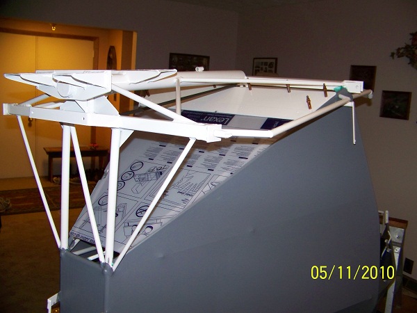

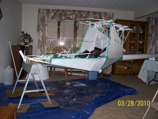

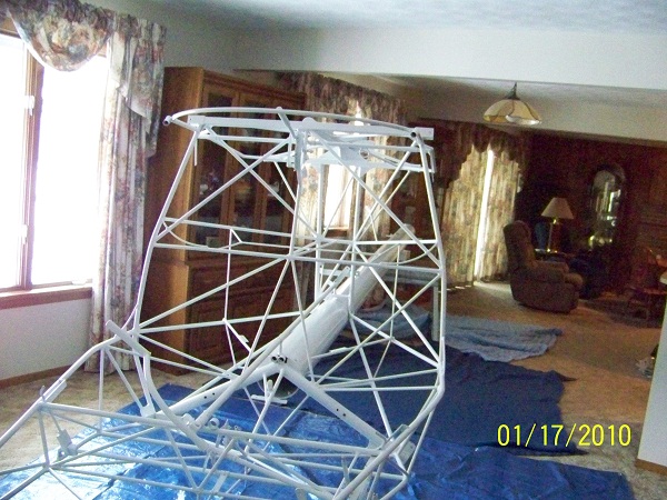

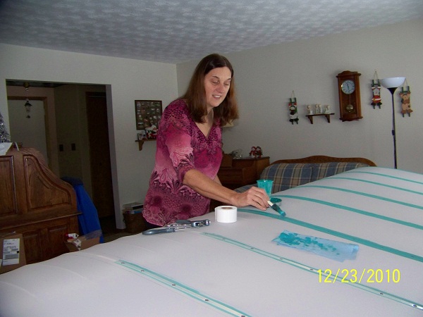

I used Stewarts totally to cover and paint my Mark 3. For fabric I got medium weight Dacron from Aircraftspruce(not certified,much cheaper and works fine for light sport)Stewarts is waterborne and nontoxic.You need 65 to 70 degree temps.for gluing,so I did all covering in the living room and half the dining room.Even got the wife involved.This way I could keep working in winter weather here in Ohio.Never shut off the Furnace,even for brushing on the gray uv protection.You glue up large parts,rub in material,can pull back off to move or tighten then glue over top and wipe off excess glue.Great videos to follow.Finish paints were difficult do to humidity.Spraying in a booth during the winter went well do to heaters take the humidity out of the air.Warm weather was horrible,paint would not dry quick enough between coats.Kept paint gun in fridge to keep the pot cool so catalyst would last longer.Anyways the plane is done,has 26 hours of phase one flown off and having fun.Stewarts paints are not base coat,clear coat.Poly urethane with catalyst mixed with distilled water(3 part).Liked working with their glues and uv paints,mixed feelings about finish paints.Pictures attached

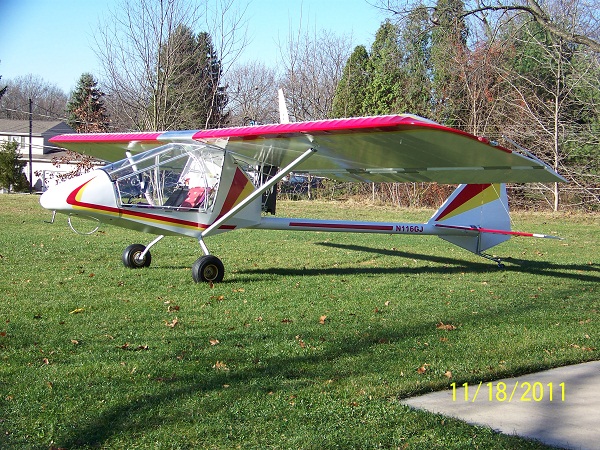

Gary, Thank you for an informative post and thanks for second post of pics ,nice looking aircraft.
What do you have for power and how does she fly?   Chris

Some of the Kolbsters will be interested in the Stewart process you describe,but all of them will want to know if that lady cementing fabric in the living room has any available sisters?

Nice looking Kolb! CONGRATS...
Question: In one of your photos, it looks like you have fairings on your wing lift strut. Did you make them yourself, buy them from Kolb or ?????

Jack,the strut fairings came from Kolb.The new struts are much heavier then what was with the original kit.I finished a plane that was started in 1993.The fellow that started it miss cut the struts.Kolbs replacement were heavy wall round aluminum not the extruded fairing shape with jury strut.The covers slide on and rivet
