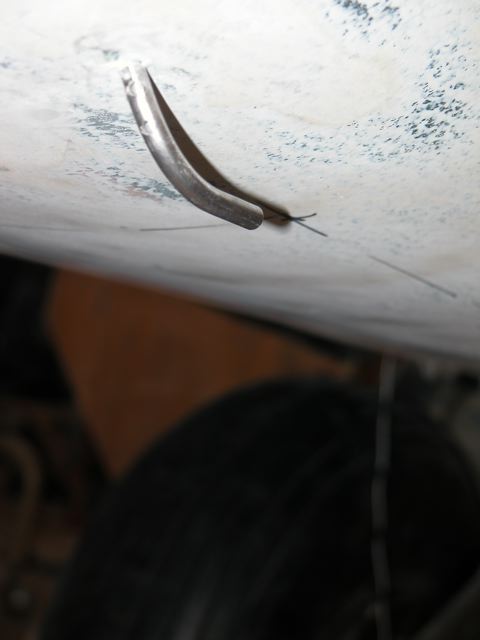

I too have vented from the underside of the fuselage; I've used the
malleable SS tubing provided in the kit and, following the manual in
terms of the orientation, have bent it so the open end of the tubing
faces forward; I have also drilled the 2, 1/8" dia. holes at the rear-
facing side of the vent tubing called for in the manual.
I am still in the build process and cannot attest that this functions
as intended. I attach a photo.
Comments appreciated, especially if something seems amiss,
Fred

<?xml:namespace prefix="v" /><?xml:namespace prefix="o" /><![endif]--> Steve,
As Fred said, point it forward. I too drill holes in the aft end in case of a bug hit, dirt from muddy ground etc. I set mine glassed to the aft bulkhead on the trigear or on one of the outboard floor supports in the mono on the starboard side. It is not wise to place the vent on the centerline for contaminates from the nose or main wheel and be clear of the exhaust. 1/4 inch tube will work OK.
The object is that the vent will positively vent and the holes in the rear keep it from clogging or building too much pressure.
Bud Yerly

There's one more reason for the holes in the rear of the vent tubes, they were originally specified by our leader Burt Rutan
to vent any rain water straight out again so that it would not freeze and block the vent.

PostPosted: Mon Apr 23, 2012 9:40 am    Post subject: Re: Talking of Fuel Vent Lines... Reply with quote
Thanks for the replies,
I'll going to go with the forward facing vent drilled at the back as this seems
to be what most of you are using with no probs.,
Steve.
