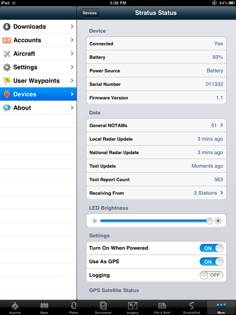

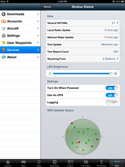

I received my Stratus unit from Sporty's the other day and wanted to give a report on my impressions for the group. I know there is a lot of debate over which app is best for the iPad, especially with the new Garmin app released at Sun-N-Fun, but I'm going to try not to get into that beyond this statement. I have used Foreflight since version 1 or 2 and have only tried WingX a little. Because I am used to Foreflight and the navigation and functionality, I have not liked my experiences with WingX, but as has been said before, we like what we are used to. I use Foreflight for all of my flight planning (I usually use www.weathermeister.com for keeping up with the weather for my trip, but use Foreflight for all actually route planning, flight plan filing, and charts and plates while flying). I have Foreflight on my iPad 2 Wifi and iPhone 4. I have used a bluetooth GPS that required jailbreaking the iPad, but when that broke (left it on the glarshield in the Florida sun for 3-4 hours one day and the battery swelled and broke the case), I bought the Bad Elf. I wasn't very happy with the Bad Elf because I didn't like having it attached to the iPad in use, especially when bouncing around in IMC. I almost pulled the trigger on the new iPad, in which case I would have bought the 4G version, but when I didn't get the call from MacMall on the day they were starting to ship (like they promised they would), I didn't follow through with the purchase.
I was walking through the hangars at Sun-N-Fun and saw the Stratus on the first day. After a short talk with a friend of mine, we decided to buy it. We had both been saying that as soon as there was a portable ADS-B box that worked with Foreflight, we would get it. We split the cost and ordered it as well as the external antenna (which we haven't received yet). We mainly wanted ADS-B for weather, because we were almost to the point of getting the unit that would get XM weather onto the iPad, but liked the thought of no subscription better.
We just made a flight in N33DQ (Cessna 182) from Arkansas to Florida through a lot of IMC, but it was a couple of days too early for the Stratus. That would be the real test, especially because of the ADS-B service areas and all of the local radar activity. Unfortunately, the screen shots I have now are shots with no rain within 250nm or more of where I was flying, and not a cloud in the sky, but I will share some of them anyway.
Now, for my experience with the Stratus. YMMV, but this is my thought after my short time using it.
For the cost, I think it's about as cheap as any ADS-B unit that I have seen, and I figured it would cost about the same as a year work of activation and subscription to XM with the better plan, not counting the XM hardware.

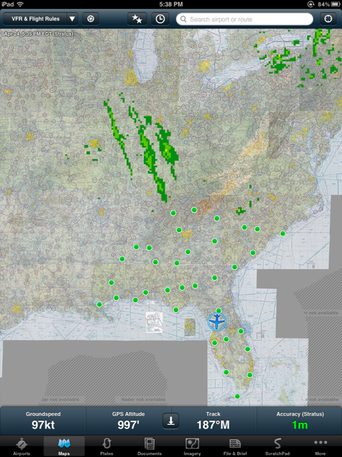

As far as what coverage is available through ADS-B, I was pleasantly surprised to find out today that winds aloft are actually available. There are no lightning strikes or Echo Tops, but METARSs, TAFs, NOTAMs, Winds Aloft, Radar (high resolution regional and low resolution nationwide) and PIREPs are all available (among a few other things that I usually don't spend much time with). Personally I really like flying with Echo Tops in the -10 because it usually accurately lets me know if I will be able to get over the tops or will have to go through. Lightning would be nice to have, but usually avoiding the red nexrad (which is a good idea) will keep you away from most strikes (which is a very good idea), in my experience. I will miss those two features, but the most important features for me are METARs, TAFs and Radar.
We took off from X35 with the Stratus on the glare shield of the RV-10 and watched the LED's on the unit as well as the indication in Foreflight of when we got a signal. We got the signal at about 5-600 feet AGL. Remember that we are in central Florida, so the ADS-B coverage here is very good. We had as many as 9 stations at a time in our short flight up to 5,500 feet MSL. I really like the Status page (see attached pictures) that gives you the information on the Stratus. It shows the connectivity, battery status, power source, etc and then gives information on what data has been downloaded and how long ago. It also shows the grid of satellites that the unit is receiving location from and how good the signal is. The accuracy of location, including GPS altitude, is the best I have seen among the bluetooth GPS, Bad Elf, onboard GPS and the Stratus, with Accuracy usually 1-2m.

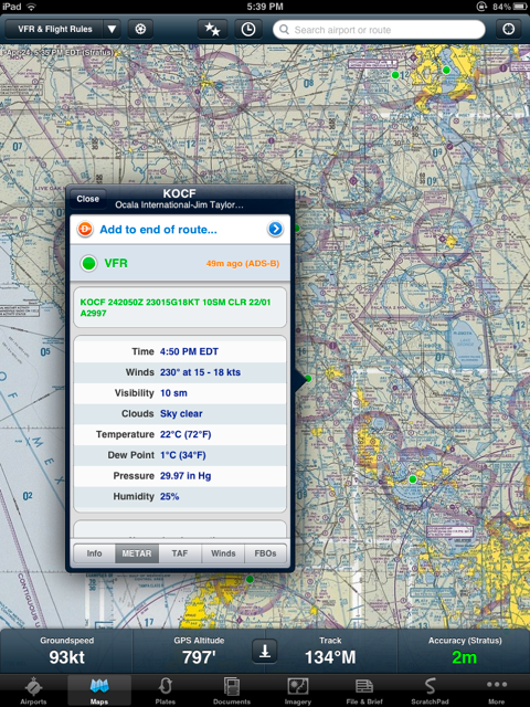

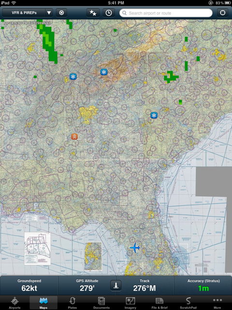

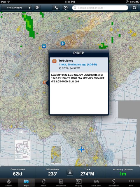

As you can see from the pictures attached, and as I have already mentioned, the weather here was way too good to get great pictures as to the usefulness of the Stratus, but it's the best I can offer so far. I usually just keep up the map screen with the Radar and Flight Rules shown. For information on a specific airport, you can just tap on the dot and it will pull up the Metar (and TAF and Winds Aloft if available). If you scroll down on the pop-up, you can see the METARs of other local airports, as well as how old the report is. We must have been getting some medium and/or high altitude ADS-B stations, because we were getting national CONUS Radar as well as a good range of METARs, PIREPs, etc.
If you zoom out on the map, only the bigger airport Flight Rules show up. If you zoom in, it shows everywhere that reports. It will also paint the surface winds, cielings, temperature, dew point spread, cloud cover, etc. the same way that it does the Flight Rules, but this display is my favorite for overall information. It will only show one of these at a time, as well as Radar at the same time. It will also show TFR's on the map for those who aren't flying "in the system".
My overall impression is very good. I am looking forward to taking a trip outside the normally shown coverage area, especially after I get the external antenna, so I can see how accurate the coverage maps are in the 10-18,000 foot range. One nice thing is that if you are going through a relatively small area of weak coverage, the information stays on the iPad. It just doesn't update, so you still should have information, which will start updating as soon as you get back within coverage.
The battery on the Stratus has been quite impressive so far. It comes with a USB cable for charging, as well as an AC adapter, but in a 45 minute flight the battery was still in the 90%'s. It seemed to stay put really well on the glare shield and it is low profile, so it doesn't get in my way at all for flying.
Can it replace XM? In my opinion, for a great deal of my flying, yes, mainly because of where I live and where and how I fly. I much prefer the screen size of the iPad to the Garmin Aera, and I like the interface much better than the Aera. As an all-in-one unit for flight planning, preflight weather, enroute charts, plates, enroute weather (with the Stratus), I haven't used anything I think would work better (especially for moving from plane to plane) than the iPad, Foreflight and the Stratus. It is not for everybody, but for those within the coverage area, who move from plane to plane, who don't want to have the monthly subscription, I highly recommend it based on my experience so far. I'll try to post again after I have taken it on a longer trip through some IMC.
