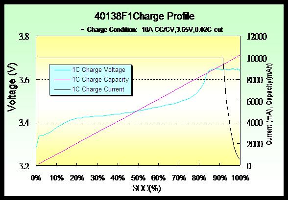

The main problem with these batteries is that they require a totally
different way of charging. A lead-acid battery can be connected in
parallel with the alternator, and the lead-acid battery will just take
enough current to get recharged, and stops automatically. It won't get
any simpeler than that.
A LiFePO4 needs an overvoltage to initiate charging, strategically
tapered off to stop charging, and each individual cell needs to be
carefully monitored and balanced. It takes a lot of complicated
electronics, something we tend to avoid in aircraft. (You might look on
some wiki's on this subject to see what is needed to recharge these
babies properly).
The implication of all this is that you can not just connect the battery
in parallel to the alternator. In real life this means that you need to
run the ship entirely off the alternator, and the battery is connected
to the bus, not parallel, but via its complicated charger. If the
alternator momentarily needs some support from the battery it won't be
able to get it. Sure you can switch over to battery power, but you can't
use the alternator and the battery at the same time. Also, if I remember
correctly, the cell voltage of a LiFePO4 is 3.2 Volts. So you need to
operate at 12.8, which is quite low, or at 16 Volts which is a tad too
high. Normal lead-acid batteries parallel to the alternator operate at
13.7 to 14.5 Volts, and this is, not coincidentally, the voltage your
avionics is designed for.
LiFePO4 might become an interesting alternative once aircraft rated
chargers are developed, and when avionics is adapted to operate on the
new voltages. This is just not the time to do it, unless you want to be
the guinea pig.

PostPosted: Sat Apr 28, 2012 7:24 am    Post subject: starter battery - LiFePO4 Reply with quote
I believe that a 12 V LiFePO4 battery is quite safe if used with care.
It does not have a thermal runaway mode, but will burn, not explode, if
mistreated to an internal temperature of about 800 șC (well above the
melting point of aluminium).
By the way, LiFePO4 is not for low temperatures; one example increases
internal resistance (4 mOhm) below 10 șC as follows: 20 mOhm at 0 șC, 40
mOhm at -10 șC etc.
How I intend to use with care:
1. Charge with a CC/CV regime, just like a lead-acid battery.
CC: small alternator, charging current guaranteed less than 2C
CV: maximum charging voltage 14.5 V; less is ok but the maximum SOC will
be less than 100%
2. Cell balancing is much slower and worse than with a lead-acid battery
(because a fully charged cell largely stops passing current).
Mitigation:
- long stays at CV interrupted by shallow discharges - normal starter
battery use actually
- apply an external shunt (3.70 V) across each cell to speed up
balancing if/when needed
Monitor:
- all cell voltages must remain below 4.00 V; remedy: stop charging
3. Replace if ever discharged to below 20% SOC
Monitor:
- battery voltage must remain > 12.8 V; remedy: if needed carry on
discharging, but do not recharge, replace
4. Have 2
I designed a "monitor & top equalizer" for attachment to a Shorai
LiFePO4 battery. It has just two indications: 1. a cell has a shunt
operating, 2. a cell has a shunt operating but even so its voltage
exceeds 4.00 V.
According to the battery suppliers no equalizing or monitoring is needed
- which may be right ofcourse. Neither of the indications may ever show.
On the other hand - they do sell balancing chargers...
Attached a typical charge curve for a LiFePO4 cell (author unknown). See
the current drop when a SOC of 100% is approached.
Jan de Jong
 Filesize:  42.82 KB
 Viewed:  19661 Time(s)

PostPosted: Sat Apr 28, 2012 7:56 am    Post subject: starter battery - LiFePO4 Reply with quote
It does not have a thermal runaway mode, but will burn, not explode, if mistreated to an internal temperature of about 800 ÂșC (well above the melting point of aluminium).
By the way, LiFePO4 is not for low temperatures; one example increases internal resistance (4 mOhm) below 10 ÂșC as follows: 20 mOhm at 0 ÂșC, 40 mOhm at -10 ÂșC etc.
CV: maximum charging voltage 14.5 V; less is ok but the maximum SOC will be less than 100%
2. Cell balancing is much slower and worse than with a lead-acid battery (because a fully charged cell largely stops passing current).
Mitigation:
- long stays at CV interrupted by shallow discharges - normal starter battery use actually
- apply an external shunt (3.70 V) across each cell to speed up balancing if/when needed
Monitor:
Monitor:
- battery voltage must remain > 12.8 V; remedy: if needed carry on discharging, but do not recharge, replace
4. Have 2
I designed a "monitor & top equalizer" for attachment to a Shorai LiFePO4 battery. It has just two indications: 1. a cell has a shunt operating, 2. a cell has a shunt operating but even so its voltage exceeds 4.00 V.
According to the battery suppliers no equalizing or monitoring is needed - which may be right ofcourse. Neither of the indications may ever show. On the other hand - they do sell balancing chargers...
Attached a typical charge curve for a LiFePO4 cell (author unknown). See the current drop when a SOC of 100% is approached.
Jan de Jong
<40138chargeprofile.jpg>

PostPosted: Sat Apr 28, 2012 8:44 am    Post subject: starter battery - LiFePO4 Reply with quote
Probably a LiMnO2 battery. Not safe indeed.
Jan de Jong
On 4/28/2012 5:52 PM, david park wrote:
Recently seen a thermal run away on a seneca where battery is in the nose. Glad i was not in the air with it.!!!!!!
> Mitigation:
> Monitor:
> Monitor:
> - battery voltage must remain> 12.8 V; remedy: if needed carry on discharging, but do not recharge, replace
> 4. Have 2
> I designed a "monitor& top equalizer" for attachment to a Shorai LiFePO4 battery. It has just two indications: 1. a cell has a shunt operating, 2. a cell has a shunt operating but even so its voltage exceeds 4.00 V.
> Jan de Jong
