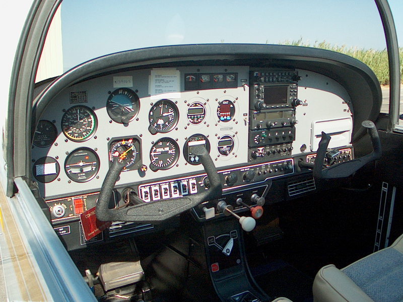

Here is Bill Kelly's plane.

I have a set of Gary's yokes in my Tiger, and they look so much better than the originals. Nice and clean, no wires hanging out by your leg for the PTT.
http://www.aucountry.com/index.html
He put them in several years ago, and they still look pretty much new.
