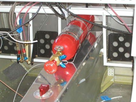

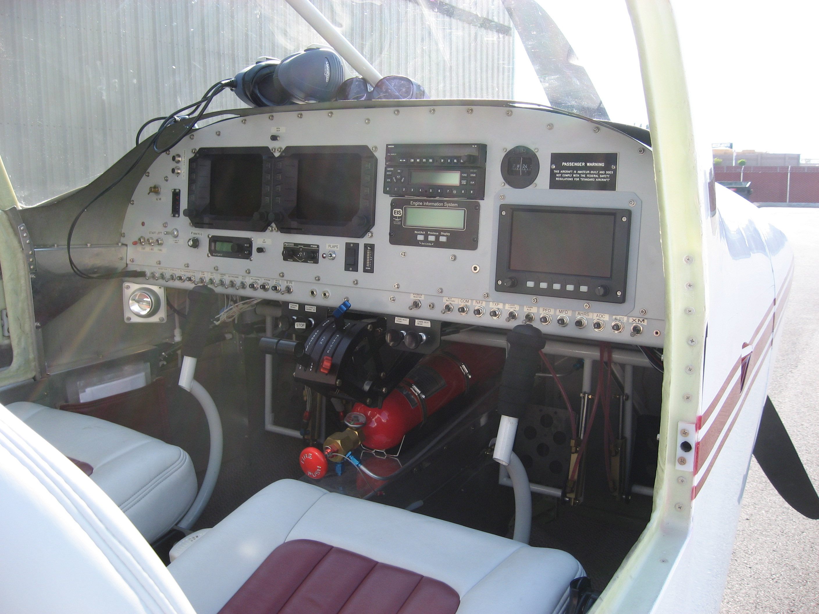

My answer to the fire problem (hope I never need it), 10# of Halon sprayed between the firewall and baffling and over the engine. From Stroud Fire Safety OKC

A before and after photo; I teed it at the firewall, one sprayer was clamped
near the spider and the other was between the firewall and baffling. Be sure
and isolate engine vibrations from the sprayers by a rubber flex tube
between with hose clamps.

If you are worried about fire, think fire suppression. Try http://www.stroudsafety.com/FireExtinguisherSystems.html
All of that fiberglass is going to burn well with a lot of noxious fumes. It's best to put it out. Fuel selector OFF, pull the pin and blow the bottle.
