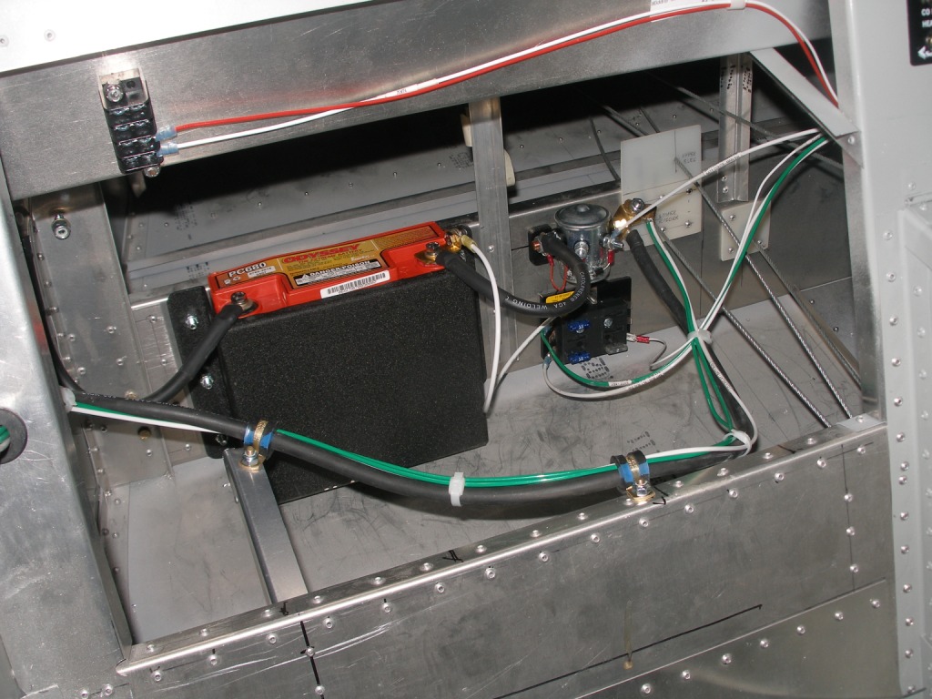

My 601XL has a Corvair engine. I mounted the battery, along with the battery contactor and battery bus (fuse block) behind the passenger side seat. (see photo). I later moved the fuse block to the floor to make it more accessible.
Jay
 Filesize:  204.29 KB
 Viewed:  5844 Time(s)
