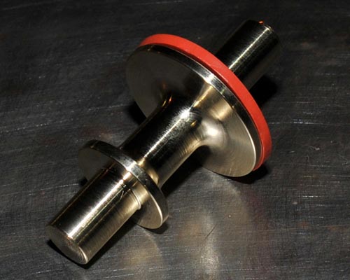

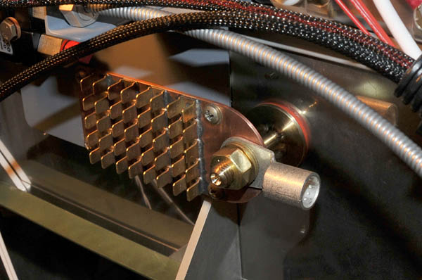

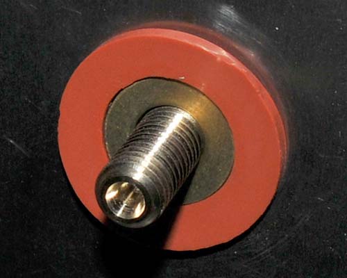

stuart(at)stuarthutchison
PostPosted: Sat May 05, 2012 1:33 am    Post subject: Aluminum bronze - conductivity Reply with quote
Hi Bob,
Maybe I didn't explain myself well, I'm a bit intrigued by your last comment. I appreciate that keeping the number of joins down is priceless, but since stainless is such a poor conductor, I would have expected to need to bond the stud to something else and not rely on current radiating out through the thin stainless firewall material? Probably overkill, but I made mine like the attached photo, which will have a short # 2 CCA fatwire between the forrest of ground tabs and an engine mounting bolt where there is chrome-moly structure bolted to a large part of the aluminium airframe. All of the bonding contact areas on my stud are at least 3/4", while the main shaft is 3/8 diameter, as are the threads and nuts. There is an silicone insulating washer on the front and back of the firewall for vibration absorbption as well.
.... I guess I'll just use di-electric grease to keep the air out at the point where the stud meets with the firewall, or perhaps make a phenolic bush to insulate it from the stainless, then bond the stud to a substantial part of the aluminum structure on the inside (such as an engine mounting bolt)" ...
"I think clean, grease and lots of pressure are key. Additional bonding is not useful."
