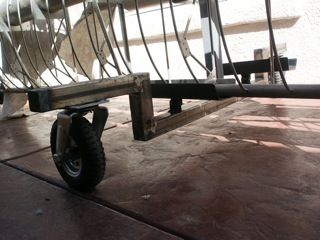

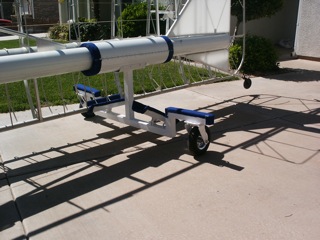

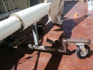

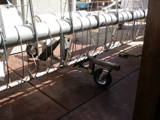

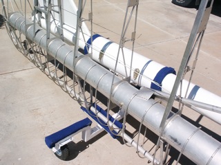

Are you looking for something like this dolly? (see photos)
The photos of the unit unpainted on my fancy colored concrete work were during it's construction phase. The ones
with the blue cushioned upholstery are the final product.
Mike Welch
