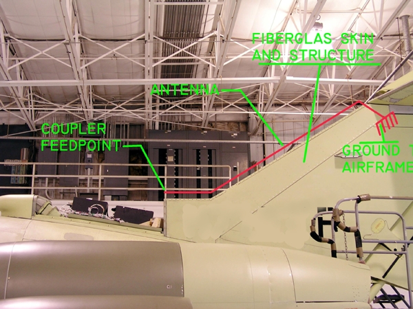

I worked what one might call the ultimate ground
loop example for RF on an airplane that featured
a HF communications antenna as part of the leading
edge structure of the vertical fin. This was a
'product upgrade' from the legacy long-wire antenna
that used to adorn the top of the airplane. Owners
of these $10 million$ airplanes really liked it
when those wires disappeared.
[img]cid:.0[/img]
Problem was, what used to be a high voltage, low
current excitation of a wire was morphed into
a low voltage, high current excitation of structure.
The 'antenna' part of the new design worked fine.
However, the 'ground' part of the system was designed
decades earlier to be strong, the right shape and
corrosion resistant. None of the various parts of
the airplane structure were attached to each other
in anticipation of carrying high current flows at
2 to 30 Mhz.
The unanticipated result gave us antagonistic
levels of RF in the 'hell hole' that far exceeded
the susceptibilities limits for several systems
that were also designed and qualified onto the
airplane decades earlier. Further, the problem
manifested only at specific frequencies that
shifted from airplane to airplane. The problem
I was tasked with involved generator regulators
that shut down when the transmitter was keyed
on specific frequencies.

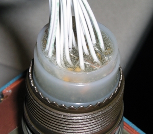

I couldn't expect all those regulators to be replaced
with modern and more robust designs. I ended up crafting a
filter-connector . . .
[img]cid:.0[/img]
[img]cid:.1[/img]
. . . which was nothing more than capacitors bypassing
certain pins to ground under the connector's back shell.
We COULD have ordered a custom connector with those
capacitors already installed but this was Dec 5th and
I was working a group of airplanes that had to be
delivered before Jan 1.
